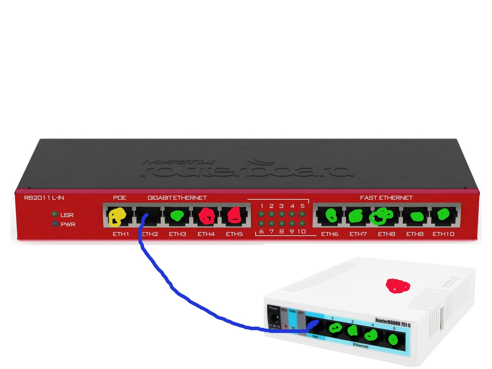

no ms paint for me im a linux guy. either way i have suck skills with images, here is a picture and here is the key for it.
yellow = wan input or internet.
green = 172.16.0.0/24 bridge 1
redish = 172.31.0.0/24 bridge 2
as you can see there is a redish spot on top of the 751g. that is for the wifi. so pretty much i need the wifi to be part of the 172.31.0.0/24 network coming from the rb2011 which has its dhcp server connected directly to bridge 2
all the green dots i need to be part of the 172.16.0.0/24 nework on the rb2011 and its dhcp server is on bridge 1.
I hope this helps and i feel like a compelte tard with the picture about to post but hey im not a graphics art persoon :slight_smile: i hope this helps and doesnt cause more confusion.
That’s perfect, just gimme a bit of time to post my answer. I’m a bit busy at the moment.

You don’t need to give the bridges IPs.
I used that to show examples of the following.
1: VLAN setup
2: Bridge setup
3: DHCP Server setup
4: DHCP Client setup
5: Functionality tests
In the example, the DHCP client only works if you successfully set up the VLANs and bridges. If the bridges on router 2 get IPs via DHCP then you know the VLANs are working.
There is no big difference between your setup and mine other than the interface type. Simply add your wireless interface to the red bridge on router 2. Remember your Wireless interface must be set to AP Bridge.

i tried to follow the guid. when i do i end up getting locked out of one of the routers. even mactelnet fails to connet. i have to default it to get back into it. i wont be able to play with again till monday morning.
one thing im doing that i dont think ive mentioned before is im taking all the ports on the rb751g and make then a switch group. one port is the master and the other 4 are slaved to it.
The switch chips can’t have VLANs as slaves so we use bridges instead and enable RSTP. Think of the VLANs as extra interfaces under a physical interface. When it’s working, you can torch a VLAN to see the traffic go through while testing your setup.
Good luck.
I finally managed to get it to work. I think my problem and initially has been the entire time is the “trunk” ports were on bridges which is why i was only getting dhcp on one side and not the other. i removed the “trunk” ports from the bridges all together and everything lit up like it should.
Thank you very much for your assistance
funny story. after i finally got all the parts to work as they should and i was finally drawing ip with wifi on the correct subnet and each port was spitting out the proper subnet as well. i started getting up set because i tried to goto the internet and was denied. for the life of me i was like what the heck. do i need new routing rules or what. i sat here for a good while thinking about it. then i remembered i started from scratch and never wrote my masquerade rule. once i applied that everything was happy.
