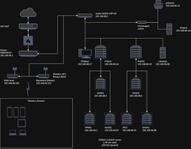

Router IP is 192.168.88.1
WG IP 10.0.0.1
Peer IP 10.0.0.2
I run my own DNS servers, and I'd like to continue using those for the wireguard peers. Hosts on my network are static. DHCP service is handled by the primary DNS server.
I've tried various firewall rules and NAT rules and nothing seems to work. Do you guys have any ideas what I'm missing?
