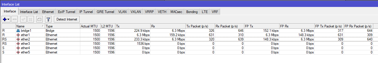

The Hex Router shows a corresponding upload usage of around 6300kb/s, which is the same as the streaming software shows, so its ok.
This is the first “problem” I ran into. Why is it that the Router does not give me the full speed of my upload?

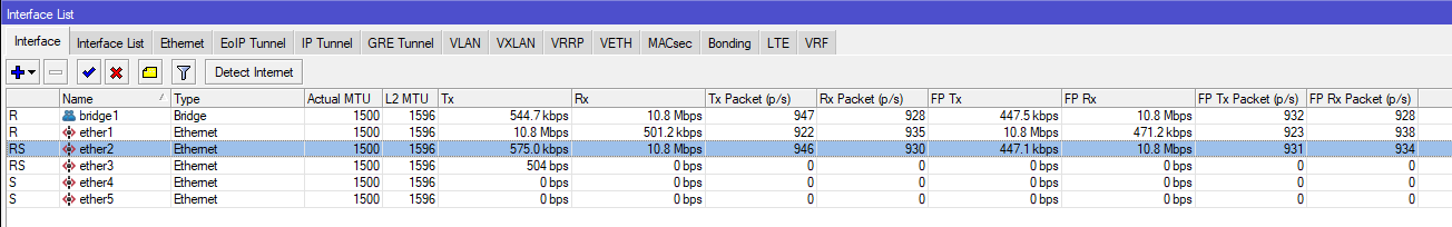

After about 10sec of streaming, the upload bitrate in the streaming software gets limited to around 5300kb/s.
This is because the Hex router decides to double the upload it gets, so it uploads with a upstream of 10800kb/s, which is double the rate I am sending to the router.
By that behaviour, my uplink gets fully packed.
Down by provider: 50mbit
Up by provider: 10mbit
Why is it doing this?
