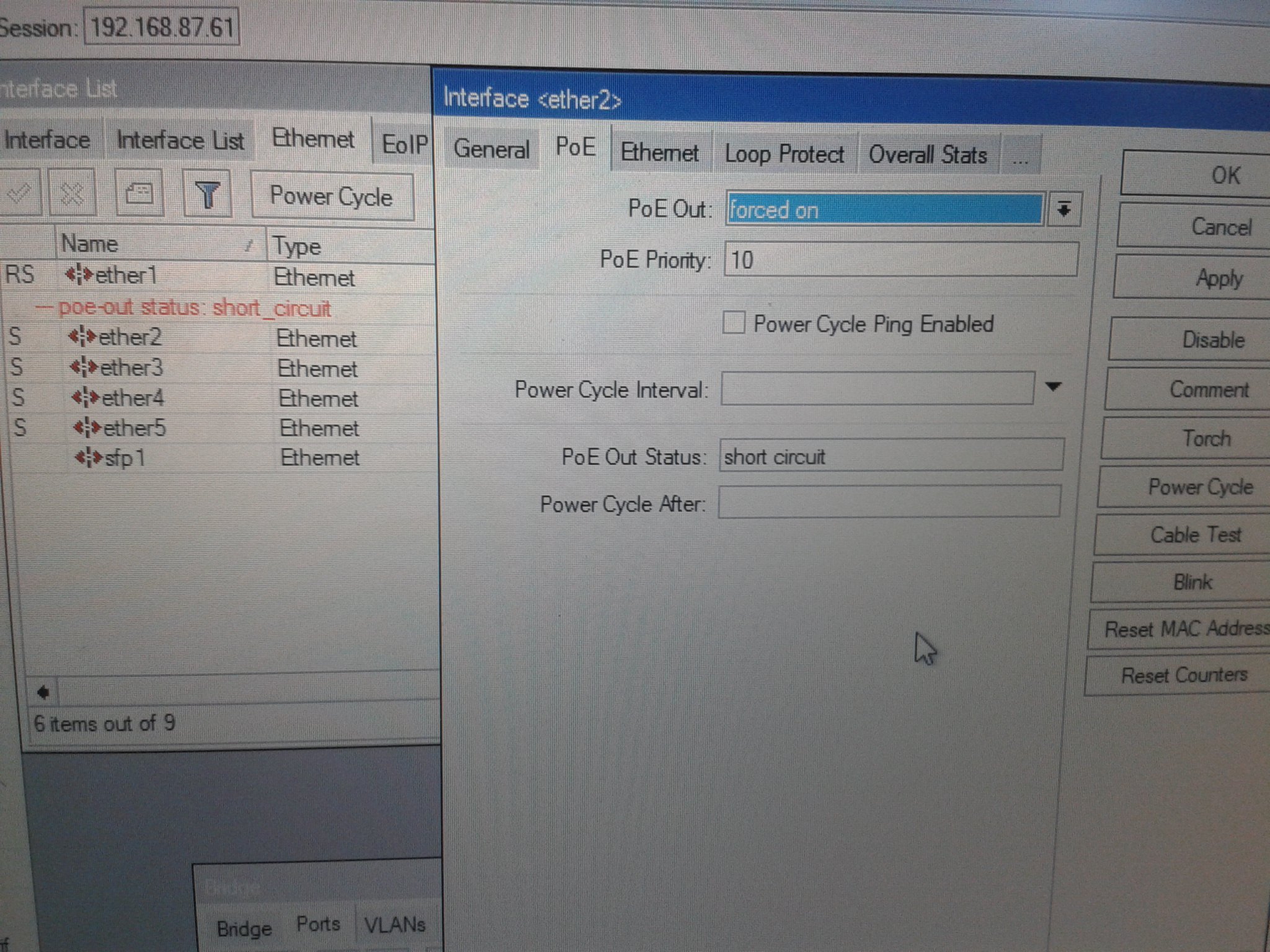

If I would power a camera, Hikvision camera, I need to activate poe output “forced ON” , and so I have 48V on eth ports even if there isn’t connected any camera.

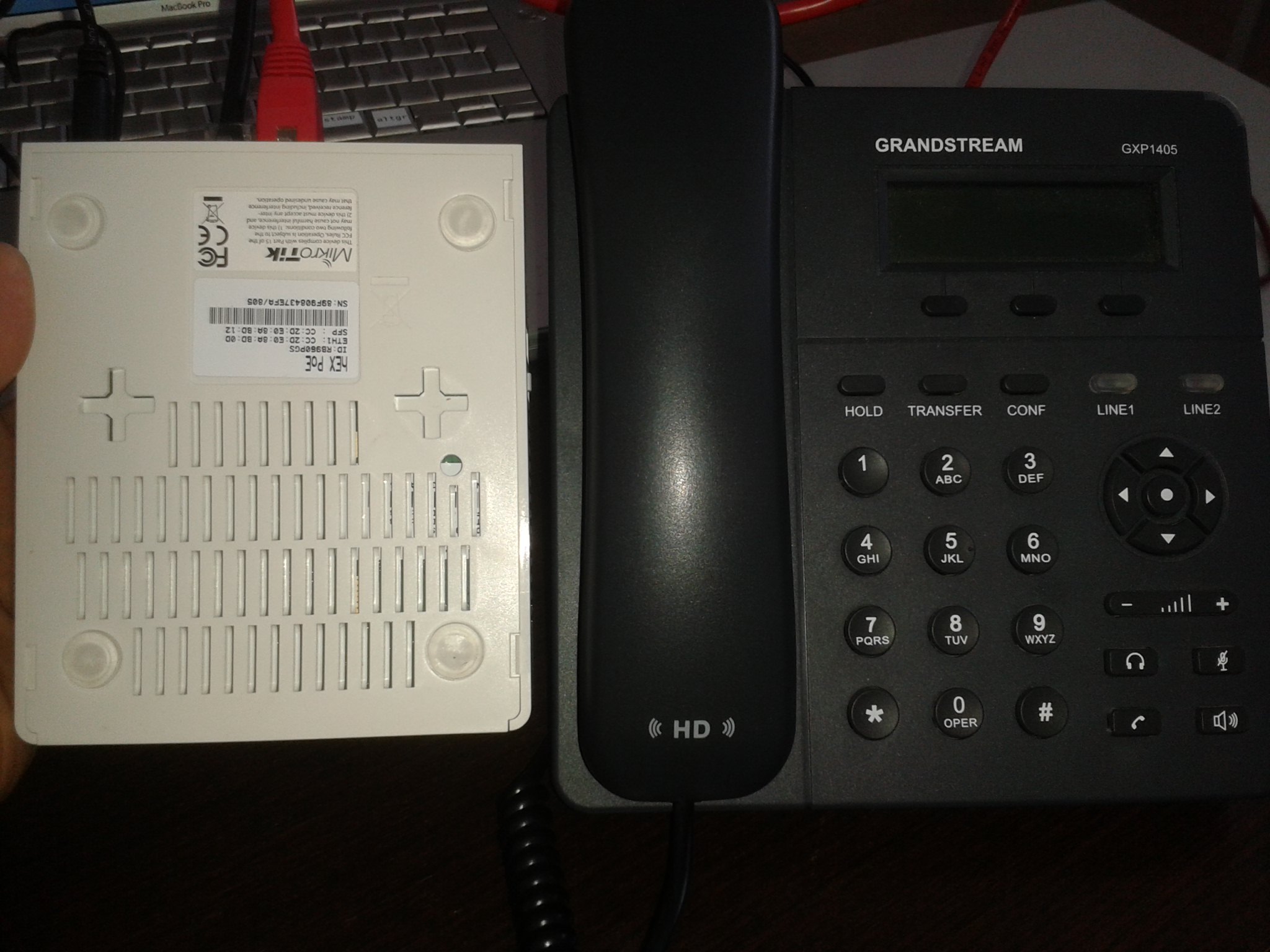

If I would power a phone, for example a Grandstream phone, hex poe won’t deliver any power to the phone, because “auto ON” doesn’t find the phone and “forced ON” finds a strange “overload short circuit” over the eth port where the phone is connected!

Why a 2W phone is detected as a short circuit?

And the behavior is that I said: poe auto on doesn’t power either camera and phone, poe forced on powers camera but says “overload short circuit” with the phone.
