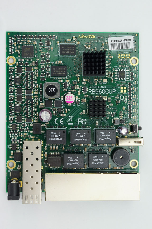

Jumper or brass contact have same functionality as reset button.
“dim lights” usually mean voltage problems, in that case you will not get any link on LAN ports, so there is no way to fix this using software.
There are UART pads on the PCB, you can connect 3.3V UART to USB adapter (or logic analyzer or scope) and see if you get anything on TX pin (there is no BIOS you can enter, but often you get at least some boot messages if the board is alive).
But “dim leds” is are usually indicating some hardware damage, like voltage regulators not running or dead chip that shorts the VCC to ground.
Check voltages on all big caps, inspect all SMDs or PCB traces for any damage (use magnifier or microscope).
If the CPU is getting very hot, it’s dead. If you see any voltage over 3.3V around the CPU, board is dead thanks to failed voltage regulator.
It helps if you have another board that works and can compare voltages side by side…
Thanks all for the responses. I’m going to declare a voltage regulator issue and not take the time to prove it out. Hex PoE RB750Gr3 gave it’s life in a test environment. But, this does cause concern as we are a free WiFi marketing startup and have two of these in production at our 1st two clients. They are both the non POE version RB750Gr3. The topic of this chain is HEX PoE RB960PGS. Our provider’s solution for existing non-Mikrotik AP infrastructure is Mikrotik routers. Based on what others have told us, Microtik is rock solid. Any router using the provider has to have OS native hotspot ability for a captive portal. Thus, that rules out Edge for instance.
