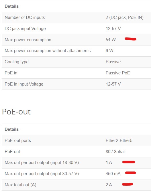

How to read the limitations?
Max power for the AT devices is 54W - 6W is 48W (max power consumption limit - own consumption)
For 24V adaptors , the max power is 24W per port (1A) , 48W total (2A)
For 48V adaptors , the max power per Port is 21.6W (450MA) , total is limited by max power 48W consumption above. But maybe not , why did they add the “48V2A96W 48 V 2 A 96 W” as stronger unit replacing the “48POW 48V 1.46A 70W” ? Or is the extra power only for the CRS112-8P-4S-IN ??
For 57V the adaptor is limited , max power per port is 25,65W (450mA), 45W (800mA) total (power adaptor limit 0.8A)
The client device must be able to work with the offered voltage !
The RBGPoE injector is limited to 2A ! There is also some voltage loss on the UTP cables.
For power hungry devices a separate PoE injector could be used on that port (with hEX-PoE PoE-OUT disabled on that port), up to 2A

I’ve never seen specification of maximum PoE-in current for any MT device.
Brochure for RB960PGS gives slightly more details about PoE-out:
On ports 2-5, Output: 1A max per port; 2A max total (12-30v), 450mA max per port; 1,8A max total (31-57v)
Using 48V power supply, the current limit of 1.8A over all PoE-out ports (4 ports, 0.45A each) translates to 86.4W. Which doesn’t correspond to “Max power consumption: 54W”.
Since RBGPOE is rated at 2A, I would assume that PoE-in ports would be able to take the same amount of current. 2A at 48V is 96W, subtract 6W of own power consumption (and slight voltage drop on input) and you approximately get the figure from previous paragraph.
