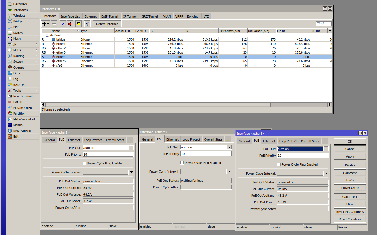

To answer myself - MikroTik RouterOS 6.48.1 - hEX PoE.
PoE works with Reolink 48V cameras (520a and 511).
Both PoE port leds are RED - is this normal - don’t know!
I am powering my unit via PoE IN (48V) because provided adapter is only 24V (and it is a big heavy brick btw).
520a examle:
  • current: 98 mA
  • voltage: 48.2 V
  • power: 4.7 W
https://pasteboard.co/JQuoRIq.png
