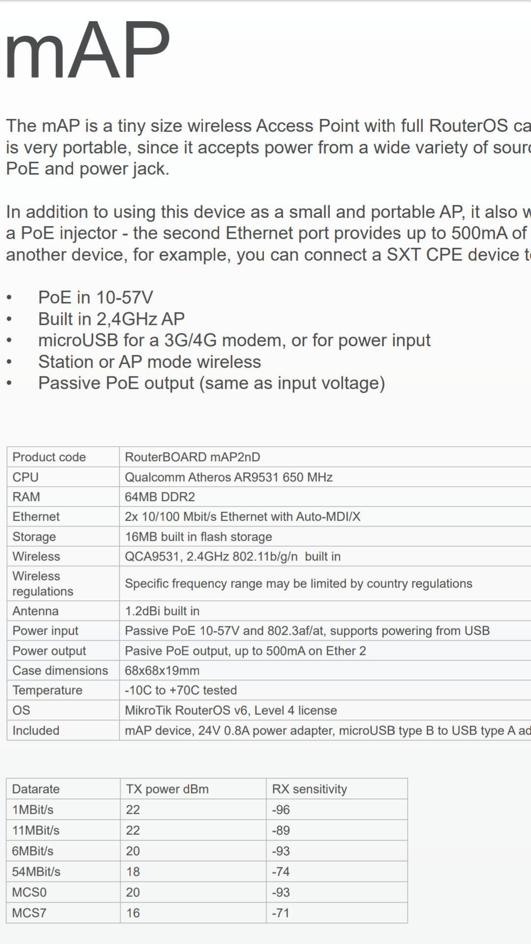

If you see the brochure, it says;
Power input: Passive PoE 12-57V and 802.3af/at, support powering from USB
And as you can see, is the brochure of mAP.
