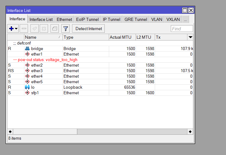

I have a Hex POE and am getting --poe-out status: voltage_too_high on port 2, 3, and 5. We are providing 57v to the power port. Port 4 sends the 57v to my wireless ap no problem. The Hex booted ok the 1st couple of times on port 2 but now always gives this error. It was the factory stock 6.49.10 firmware but no change after updating to the 7.16.1 firmware. I even tried lowering the voltage to 48v and still the same result. We’d like to use 57v as we have a device that requires 57v.
Please contact MikroTik support and add supout.rif file.
