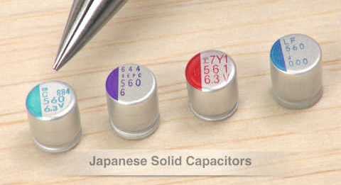

It was necessary to use solid-state capacitors (Al-E) for a long time already. The market has a large selection of solid capacitors from Japanese manufacturers CHEMI-CON, SANYO OS-CON, FUJITSU and NICHICON, which have been used for years in the motherboards of the world’s leading vendors such as Asus and Gigabyte.
Why should I use solid capacitors? First, they have a much longer service life, and for all this time such capacitors do not lose their capacity. Secondly, solid capacitors are filled with a polymer and have better stability at high temperatures, i.e. Do not lose their capacity as sharply as in the case of electrolytic ones. Thirdly, TCs provide a larger current of pulsations. Fourthly, TCs have a lower equivalent series resistance (ESR), which is why they heat less. What does this mean in practice? In practice, solid capacitors have a service life of 500 thousand hours at a temperature of 65 degrees, while the lifetime of electrolytic capacitors under the same conditions will be 32,000 hours.

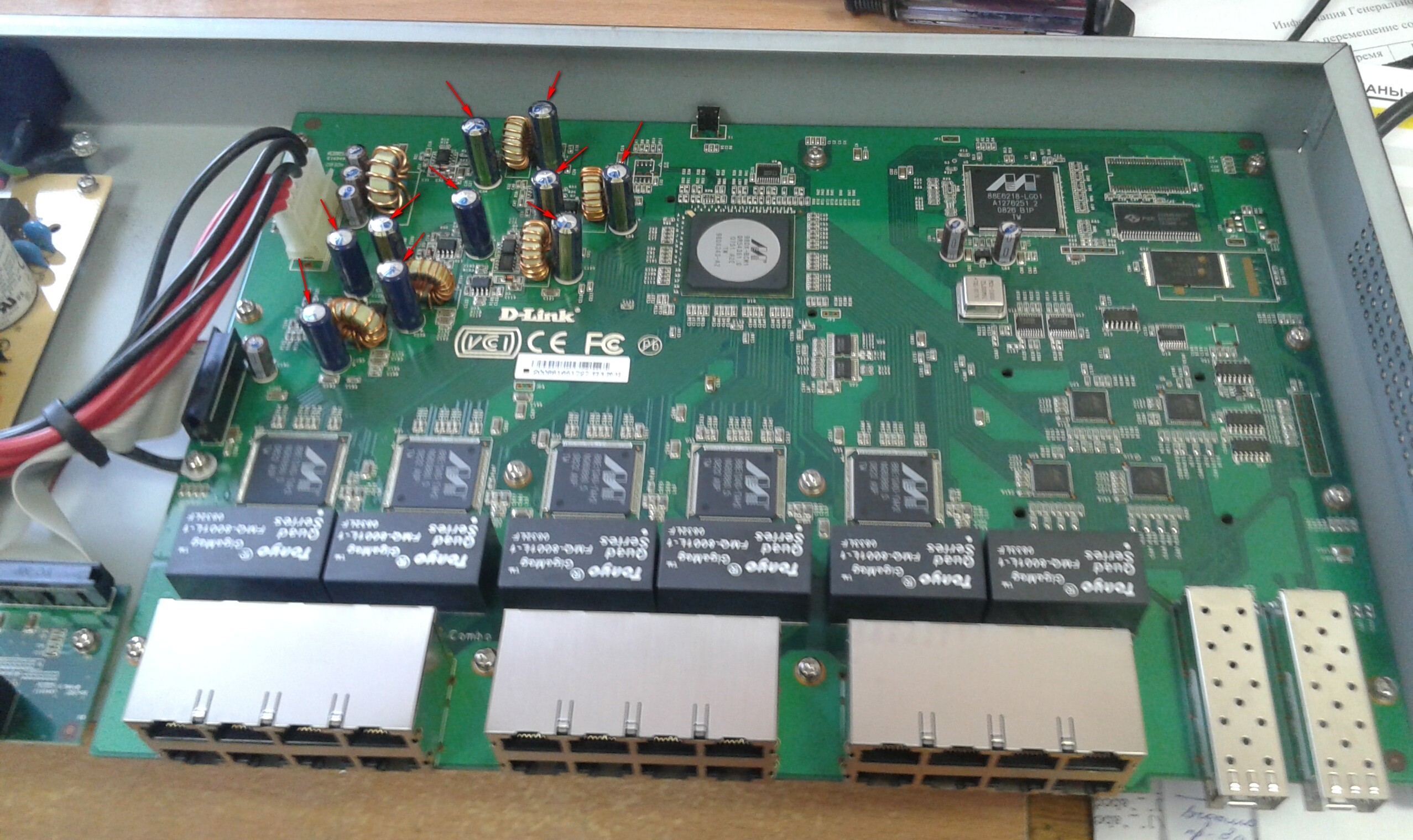

I enough equipment wit those bad capacitors that are still going strong after 20 years of service. This kind of capacitors got a bad name by heavy loads and high temperatures in computers.
D-Link’s DGS-1224T Web Smart™ Gigabit Switch blends Plug-&-Play simplicity with exceptional performance and reliability to create a cost-effective solution for a small to medium office.
