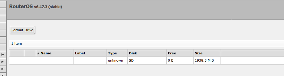

Next, I took microSD card out of adapter and placed it in the RB750Gr3’s microSD slot. The first attachment shows that disk ( From System → Disks from WebFig).

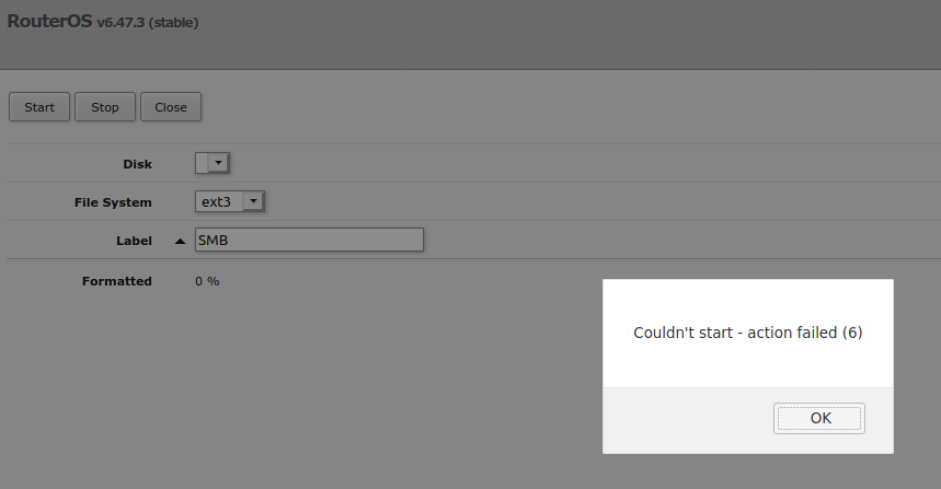

Next I clicked ‘Format’, and once there, the drop-down combo was SD, and I added a label (SMB), and clicked start. The second attachment shows the error. Notice how the drop down for “disk” has now become empty. It’s like the system ejected the disk. This is the same behavior as before.
What else can I try?
