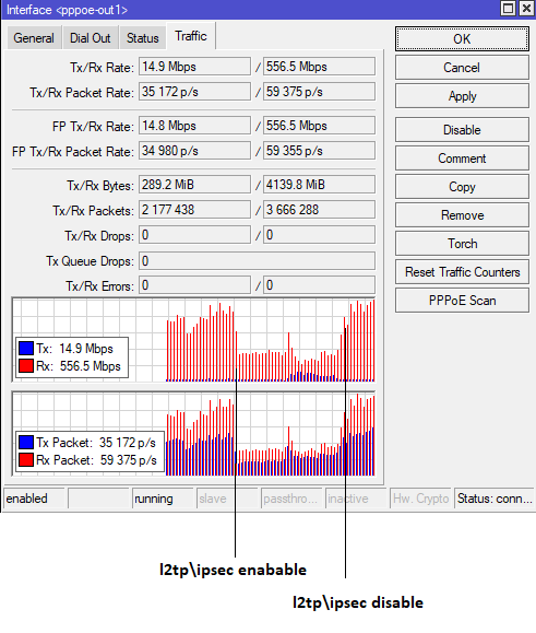

unfortunately this is a hex refresh, 7.18.2 in default configuration, and this is not the only problem, for example, turning on l2tp\ipsec immediately reduces the speed to 200-250 mbit

I just noticed in the image you posted that this was a pppoe connection. That may be significant.
I also just noticed the PPPoE part. The OP keeps saying they use the default configuration. Well, PPPoE is not the default configuration. It might be a minor change, but what else was changed from the truly default configuration? We simply don’t know.

mikrotik hex refresh, 7.18.2, reset, quick setup: internet pppoe, everyone can see the resulting configuration /system default-configuration print
and now, how to make a problem, add and run some file download, for example, https://sto-se-ping.vultr.com/vultr.com.1000MB.bin, the speed should be more than 300-400 Mbit, and now just turn on and off l2tp\ipsec (/interface l2tp-client add connect-to=1.2.3.4 ipsec-secret=12345678 name=l2tp-out1 password=123456 use-ipsec=yes user=ppp1 disabled=no)

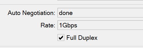

I checked the eth1 status and the port is working at 1G speed.
