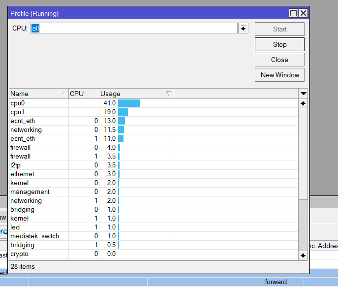

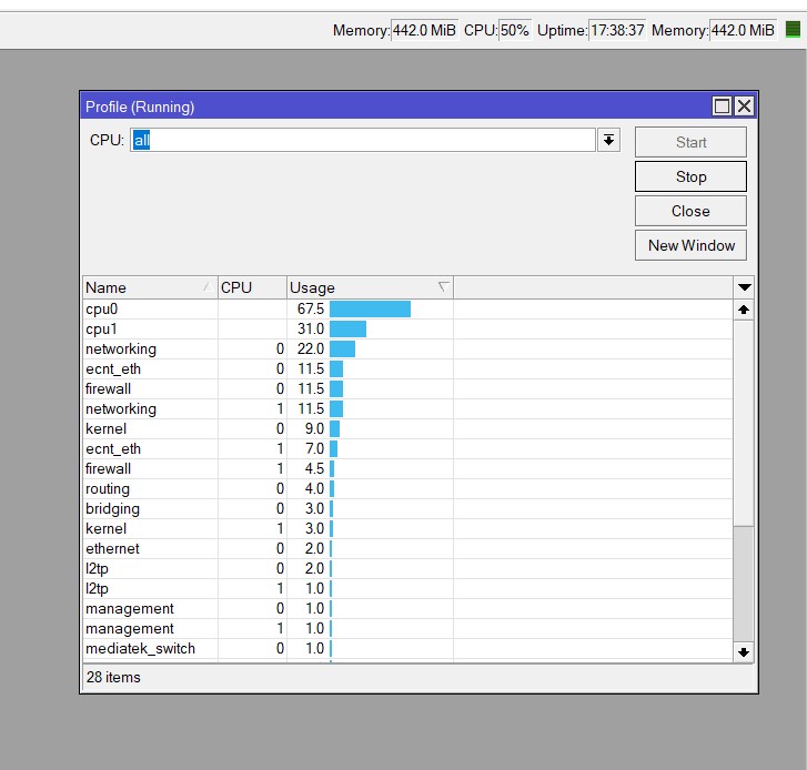

These cpu load occur near at 450 Mbit/s via l2tp client.

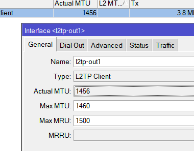

What version do you using on this metal? There is something tricky, as in first post in config this is: max-mtu=1460, but monitor shows 1456. Another hint: MTU and MRU should be equal, except there is a very exotic reason to differ.

  • MTU1456 - it’s Actual MTU.
  • With FastTrack rule the CPU load is a little bit lower:
you shouldn’t disable accept-established,related rule after fasttrack in firewall filter.
