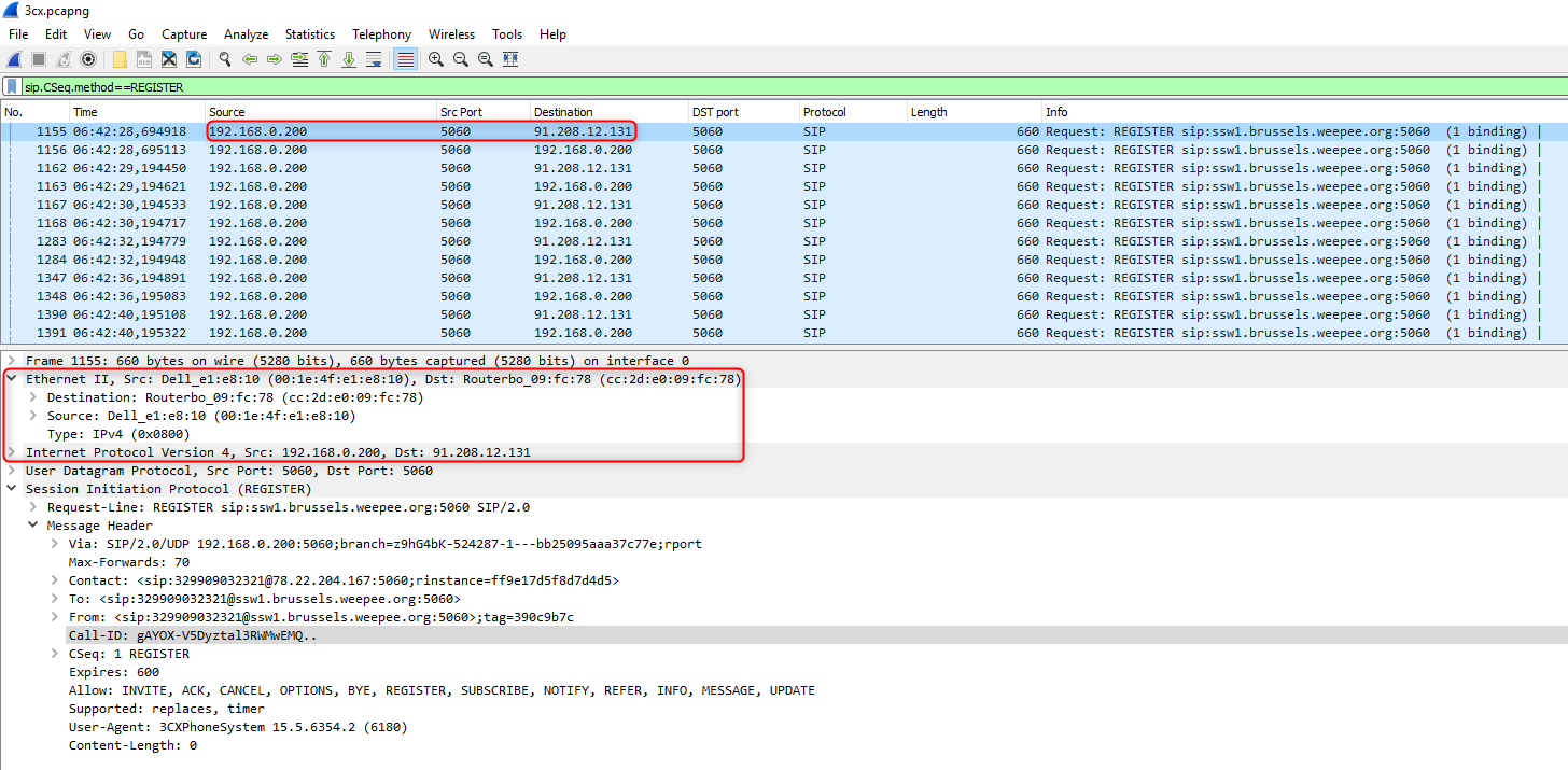

After taking a closer look at the new set of files you have sent me i can see something very weird going on. The DNS for Weepee is resolving correctly to IP 91.208.12.131 and the first REGISTER packet is sent to that destination. But then the same packet returns to the PBX from the MAC address the packet was sent to.
This is the first register message. You can see the packet leaving from IP address 192.168.0.200 which is Dell_e1:e8:10 (your PBX network card as i can see from the files) towards the destination 91.208.12.131 which goes through Routerbo_09:fc:78 (i presume this is the mikrotik).

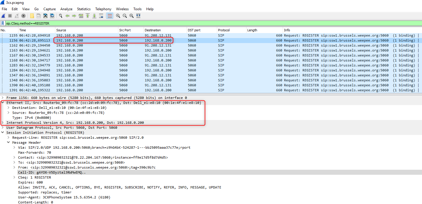

The next packet is the same packet coming back to the Mac address of the PBX from the mac address of the mikrotik as you can see in the screenshot below. Essentially the packets are in a loop and not reaching the provider. For some reason the Source IP and the destination IP are the same but you can differentiate the sender from the source mac address. And the same procedures continues with the rest of the register messages.

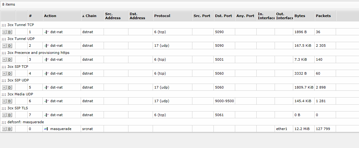

Seems like you have a dNAT rule in place , that maps all traffic destined to udp port 5060 to 192.168.0.200…but this rule is active for traffic entering LAN interface too !
Hi, what kind of config do you want to see?

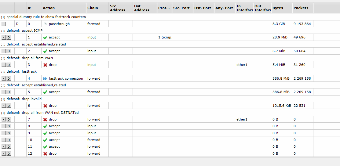

here is a screenshot from ‘filter rules’ and ‘NAT’

On dNAT rules, set incoming interface=WAN interface
@16again this did the Trick, everything works fine now.
Thanks a lot!!!
