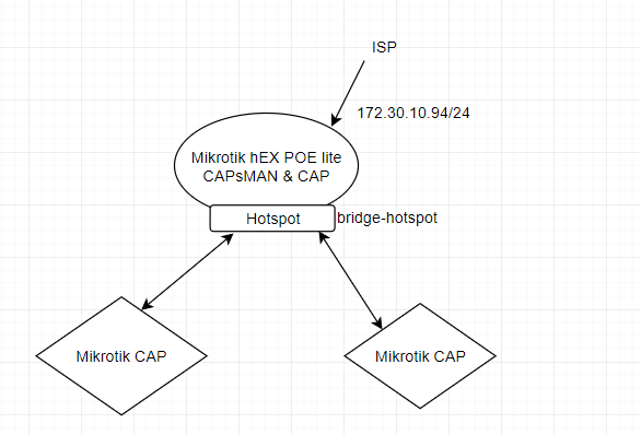

I have installed and deployed hostpot service in the office as on this diagram:
We have three Mikrotik devices. Router hEX poe lite and two access points - MikroTik cAP lite devices.

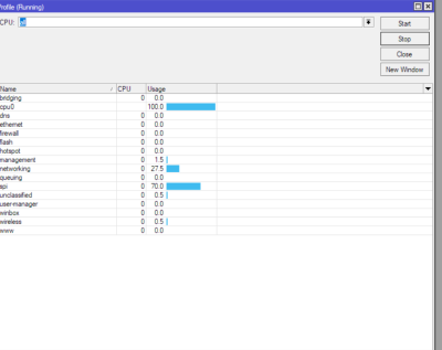

The hostpot+usermanger is configured on hEX router. The way it is configured - everything works, but it works very very slow. I have just about 10-15 workers in the office and when half of them are connected, the internet starts to work super slow. When i check hEX router CPU load it is bouncing at around 70-100%. Checking Tools-Profile(CPU) i can see that SPI takes a lot of resources. If i understand it correctly it has to do with traffic routing. And it kind of makes sense, if all 10-15 user’s traffic is routed through one hEX router it might slow things down.
2018-03-30 19_24_46-admin@192.168.92.1 (MikroTik-router) - WinBox v6.41.2 on hEX PoE lite (mipsbe).png
Can someone help me to easier things up and make CPU load less?

As I stated on your other post about umfiles, the HEX POE lite was a poor choice to run UserManager+Hotspot on. It simply doesn’t have enough resources to run all of it.
I might be wrong, but I guess SPI process is firewall. Firewall rules are omitted in printouts shown in first post..
Can you do “/ip firewall export hide-sensitive” and post output? It might be that config is missing some rule which would offload SPI engine (without compromising security).
