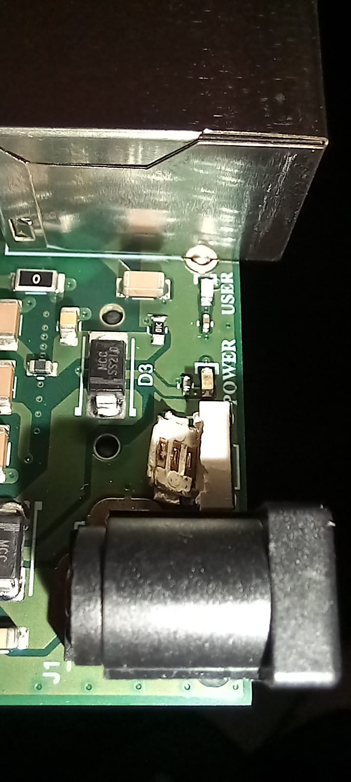

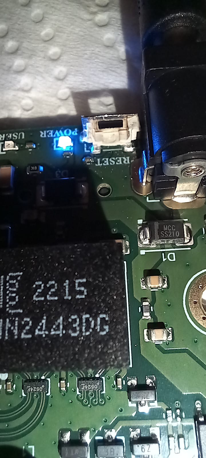

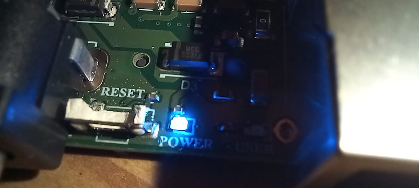

maybe you have a good idea for me ? I got a brandnew mikrotik hEX few weeks ago. Had an issue with the config, couldnt access it anymore. Tried to use the reset button and “click” it broke off the board and fell into the case :cry: . I removed it from the case already, but I have no option anymore to reset the device or do anything with it.
Any magic button or something that I can do to access it ? Or any chance to put a new button, wires or whatever ? I would love to use it, like this its 70€ for a nice white case ..

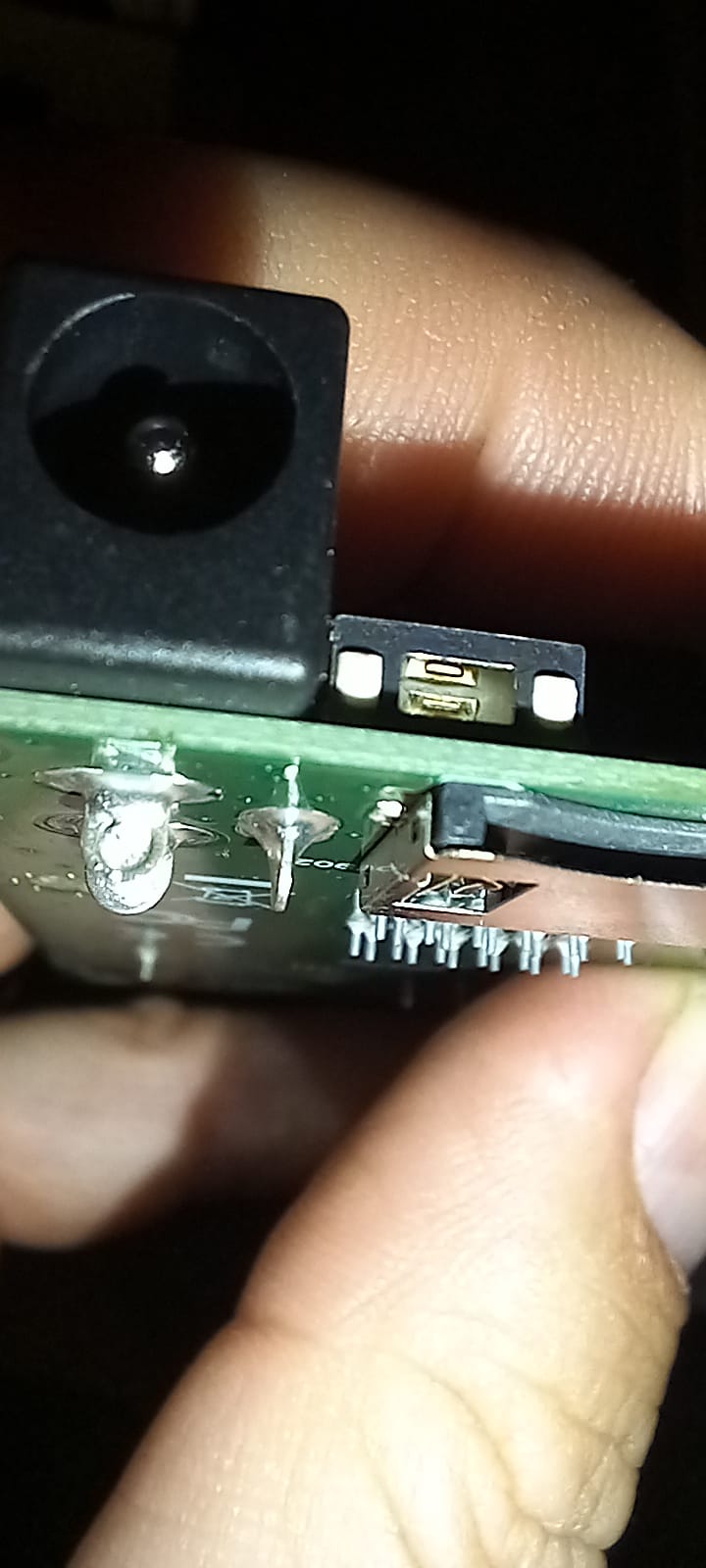

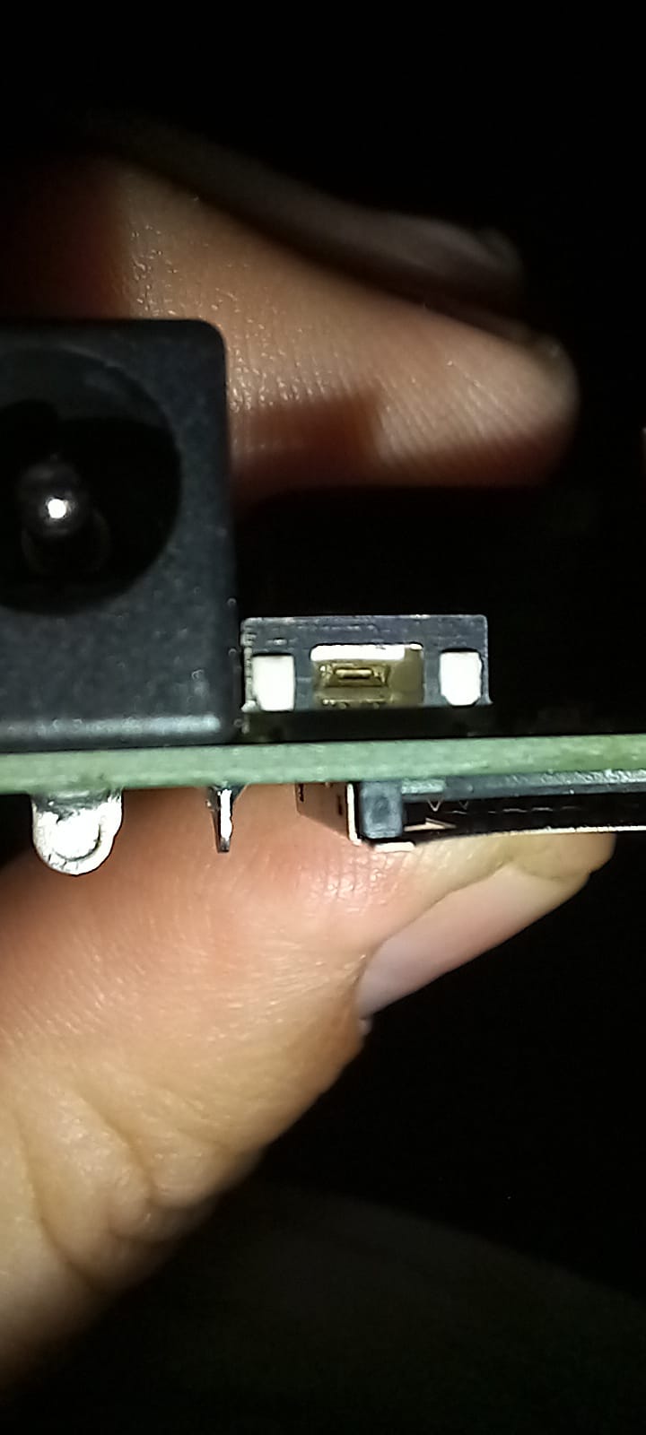

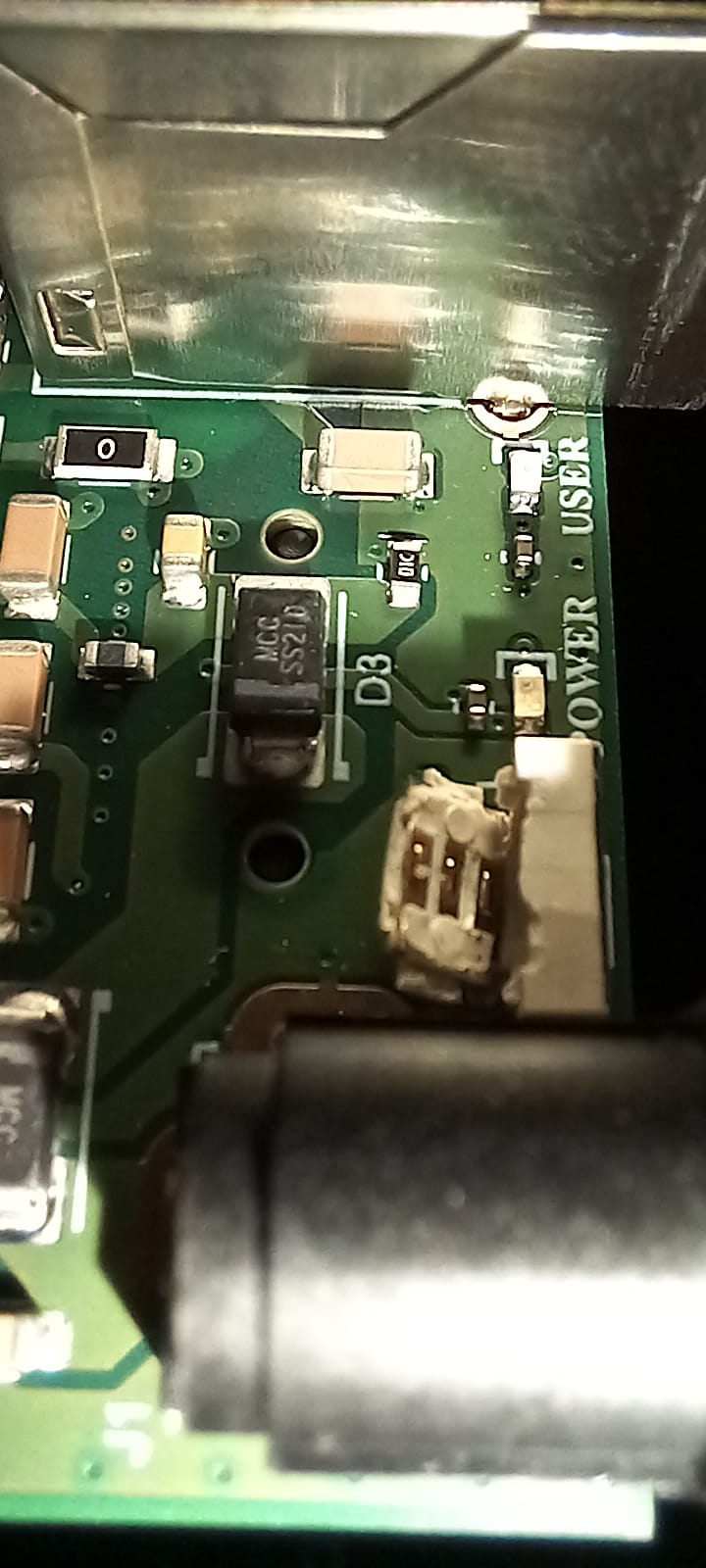

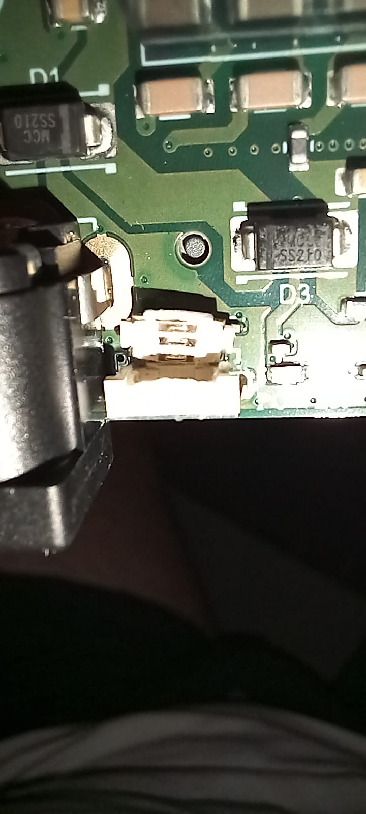

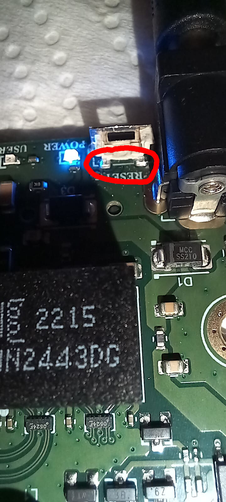

Would I need just these 2 soldings ? for wires or a new button ?

More or less :slight_smile: Find electronic service-point and ask them to solder the new button.
Any phone or TV repair shop should be able to do this.
Surely you can find one of those around ?
finding the correct part is going to be the biggest problem. That’s a small switch, and most right angle switches have multiple posts that go through solder through holes; it appears this must be surface mount (based on the picture of the other side of the board, but it may be hiding under the micro sd card holder.
It does appear excessive pressure was applied, looking at the broken switch. Whether you got it in that condition would be hard to prove. And it isn’t something that could easily happen without something being inserted into the reset hole or during manufacturing, and that may be something that isn’t tested during manufacturing “defect testing”. The RB760iGS has the reset on the side where the USB slot and mode switch is, but what is odd on the RB760iGS is that the mode switch is different than the reset switch (the reset switch on the RB760iGS looks similar to what the one on the RB750Gr3.
This is about the closest I can find. But it is not surface mount. https://www.sparkfun.com/products/10791
