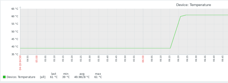

Is anybody know why after upgrading to latest ROS 6.48.6 my hEX S started reporting for high temperature?
Before upgrade it was below 40’C but immediatelly after upgrading it was dramatically increased to 61’C
Firmware was upgraded too. CPU load not exceed 5% maximum.

Have you checked the changelog, could be misreporting of health in previous versions?
Current value of 61 vs erlinden’s value of 58 is not that much of a difference.
Logically thinking below 40 is IMHO too low without cooling so something must have been off then.
So you think 60 is normal temperature for fanless router like hEX S? Just this router only the one in my network not equipped fan so I have no idea which temperature is normal.

I’d say around 60C is a normal temperature for hex S.

@erlinden @holvoetn thank you
Now I almost sure that it was misreporting from hEX before upgrading.
