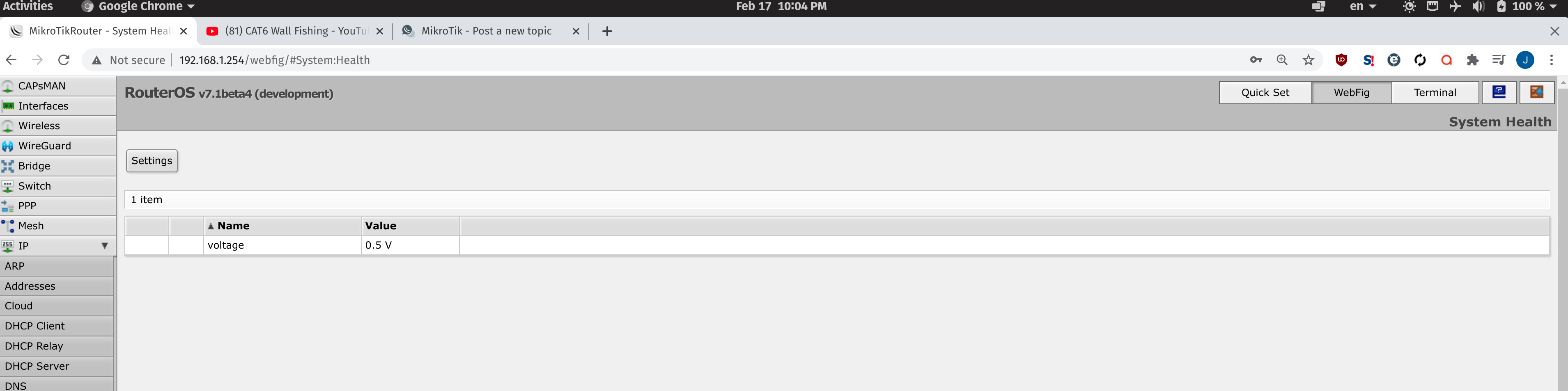

I upgraded my hEX S to 7.1beta4 today and now the PoE voltage measurement is broken. Eth5, which used to have auto on for PoE power out, doesn’t work because the voltage is now too low. I set it to forced on and now it works. However, System → Health shows no CPU temperature and the voltage is 0.5V, and it was showing 49.2V before.
Also, I noticed that in System → Packages it lets me uninstall 7.1beta4 with no problem at all (“Uninstall” button in WebFig gives no errors). This almost made me have to use Netinstall because it rebooted several times until I downgraded to 6.49beta11.

I have just upgraded to 7.1rc1 and am reporting that nothing has changed. The only thing on health page is the voltage of 0.5V, same in CLI, temperature is still missing. PoE still works the same way, it needs to be forced, it does not work on Auto.

Reporting from 7.1, switched to the testing branch. In System - Health, I can see both the temperature and the correct voltage - 24V. PoE out on the port works, which is probably related to the voltage being read correctly. I didn’t notice these fixes in the changelogs, but at least I can finally leave out the forced PoE from my config. Thank you for the fixes :slight_smile:
