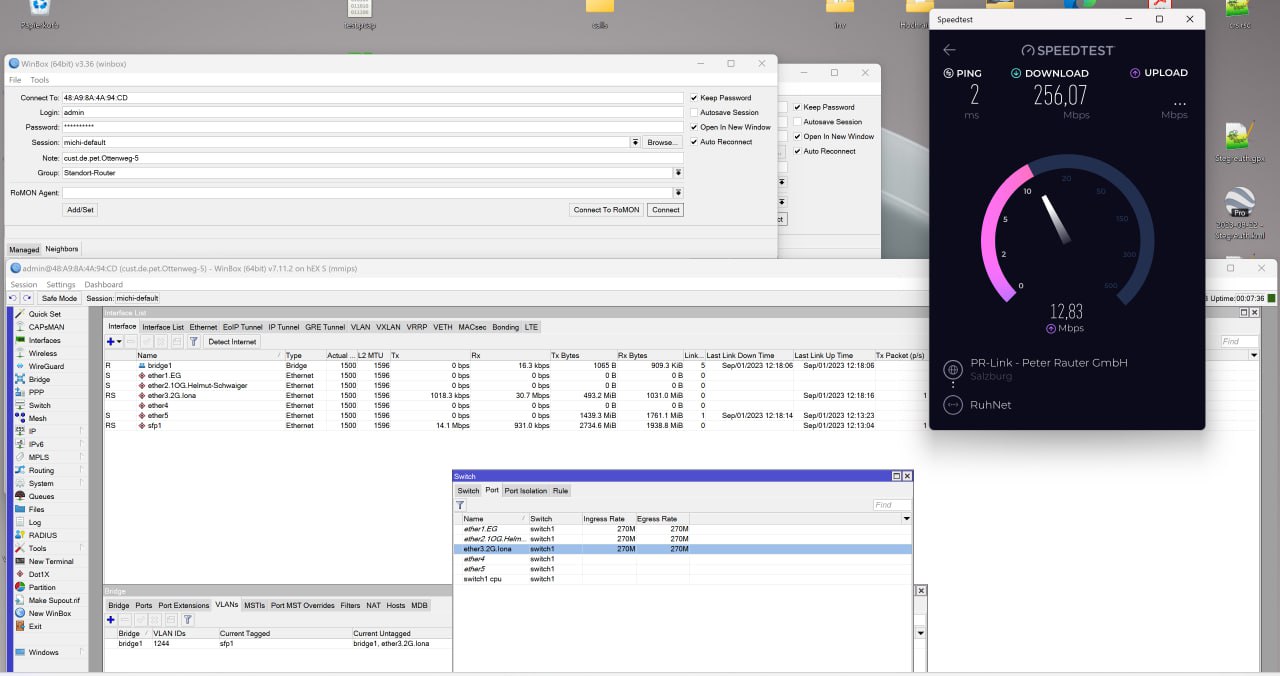

If i use the bridge to bridge all ports and go to Switch > Ports and do some testings on INGRESS / EGRESS settings. If i set EGRESS to 270M, Download is about 256M, so this is perfect. But on the INGRESS when i set 270M i only get 12M on the client on Upload.
Is the switch chip not capable to handle the correct speed for ingress traffic?
set 4 egress-rate=270.0Mbps ingress-rate=270.0Mbps
Under bridge ports the ports have the H (Hardware-Offload) Flag.
