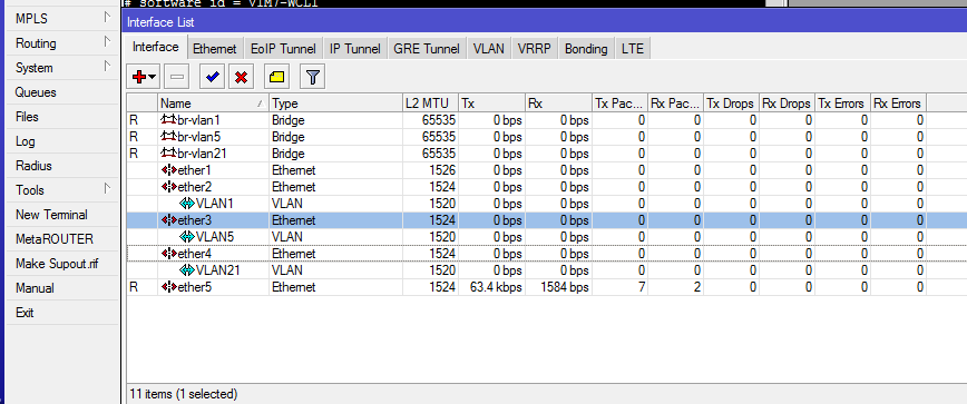

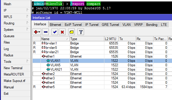

Mikrotik
Flags: D - dynamic, X - disabled, R - running, S - slave
NAME TYPE MTU L2MTU MAX-L2MTU
0 ether1 ether 1500 1526 1526
1 ether2 ether 1500 1524 1524
2 ether3 ether 1500 1524 1524
3 ether4 ether 1500 1524 1524
4 R ether5 ether 1500 1524 1524
5 VLAN1 vlan 1500 1522
6 VLAN5 vlan 1500 1522
7 VLAN21 vlan 1500 1522
8 R br-vlan1 bridge 1500 65535
9 R br-vlan5 bridge 1500 65535
10 R br-vlan21 bridge 1500 65535
[admin@MikroTik] /interface>

Could you use /export compact to upload a fuller picture?
why not configure each vlan in a different ether and not in a bridge.
I tested 3 vlan in a one ether with cisco 2950 and work fine
Thanks CelticCommons and c0d3rSh3ll , yes , i can assign each vlan for ether but the trunk is moved (also i dont know if the reason is that routerboard 750 have any limition ) and in all faq’s everyone explain the only way for do this is using the bridges … )

[admin@MikroTik] > /export compact
jan/02/1970 22:08:59 by RouterOS 5.17
software id = VIM7-WCL1
add auto-mac=no name=br-vlan1 protocol-mode=stp
add name=br-vlan5 protocol-mode=stp
add name=br-vlan21 protocol-mode=stp
/interface vlan
add interface=ether1 l2mtu=1522 name=VLAN1 vlan-id=1
add interface=ether1 l2mtu=1522 name=VLAN5 vlan-id=5
add interface=ether1 l2mtu=1522 name=VLAN21 vlan-id=21
/ip hotspot user profile
set [ find default=yes ] idle-timeout=none keepalive-timeout=2m
/system logging action
set 3 remote=0.0.0.0
add bridge=br-vlan1 interface=ether2
add bridge=br-vlan5 interface=ether3
add bridge=br-vlan21 interface=ether4
add address=172.16.YYY.2/24 interface=VLAN21
add address=172.16.ZZZ.132/24 interface=VLAN5
add address=172.16.ZZ.32/24 interface=VLAN1
set max-udp-packet-size=512
/ip neighbor discovery
set VLAN1 disabled=yes
set VLAN5 disabled=yes
set VLAN21 disabled=yes
/queue interface
set ether1 queue=ethernet-default
set ether2 queue=ethernet-default
set ether3 queue=ethernet-default
set ether4 queue=ethernet-default
set ether5 queue=ethernet-default
/system clock
set time-zone-name=Europe/Madrid
/tool e-mail
set starttls=no
/tool graphing interface
add
/tool mac-server
add disabled=no
[admin@MikroTik] >

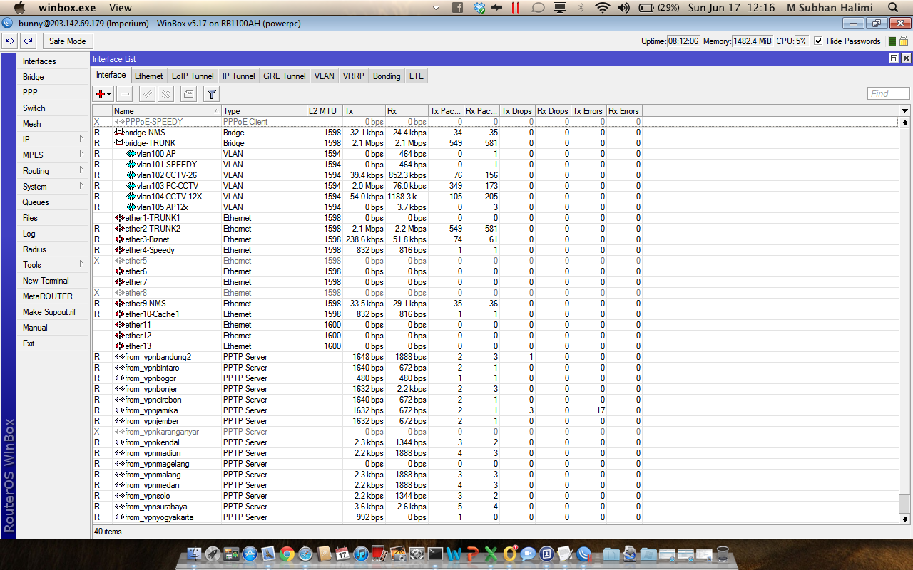

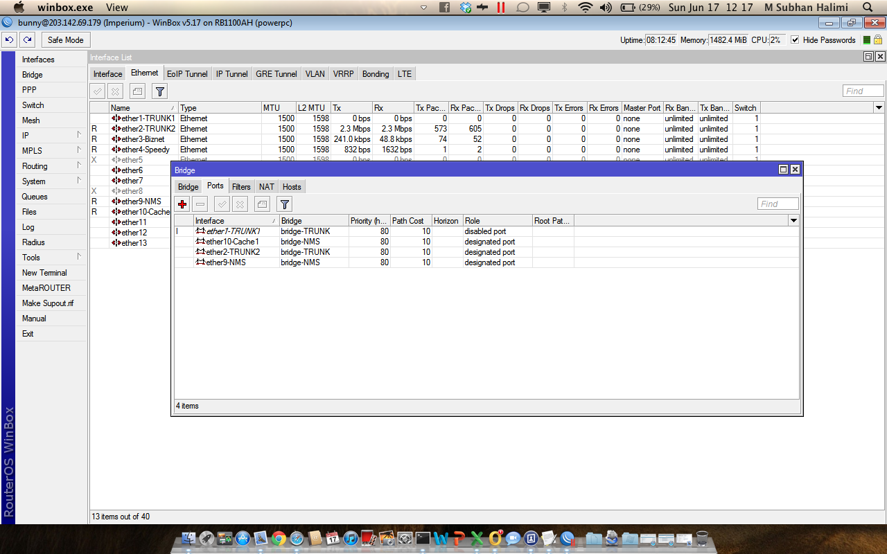

Hi .. try to make it under bridge VLAN, hope can help U
