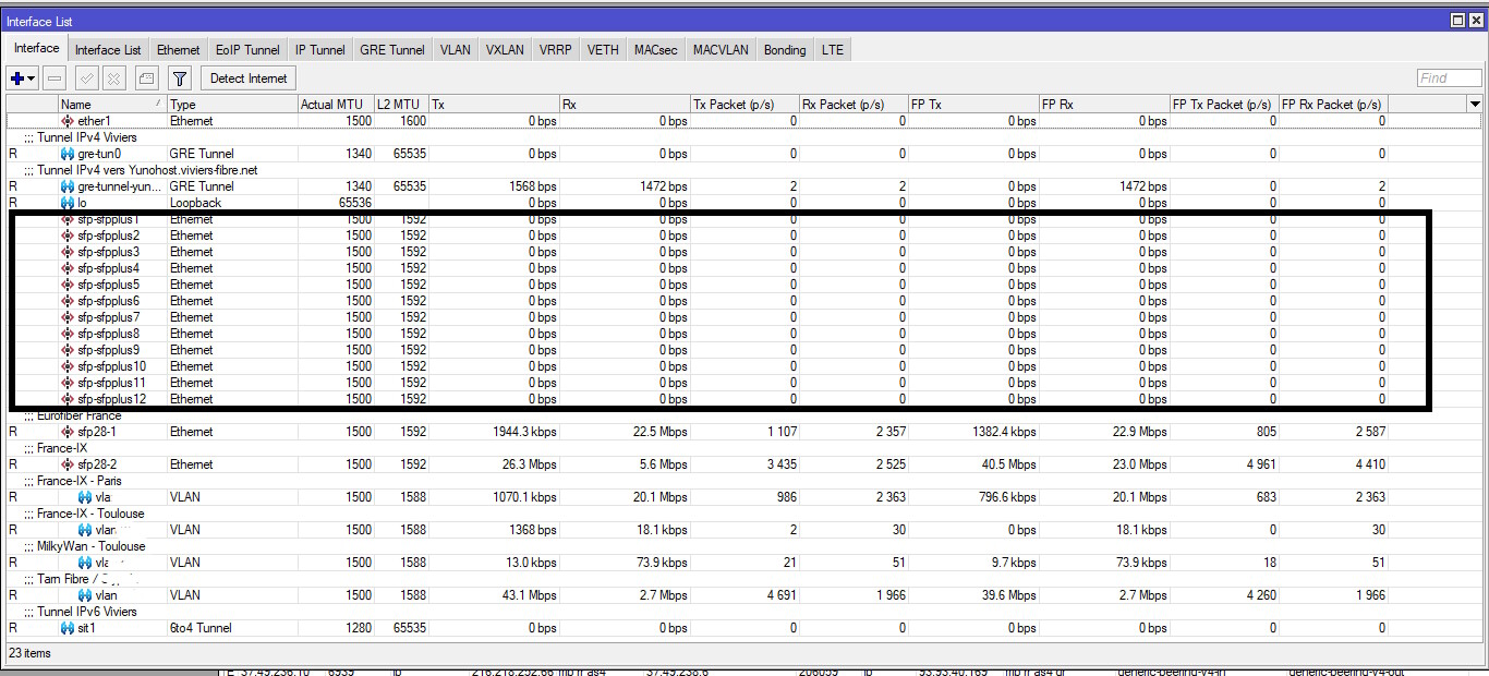

It would be nice to have an option in Winbox, to show all interfaces (as it’s the case right now) or to show only the used ones.
Some devices have plenty unused interfaces that we often don’t need to see under Winbox…

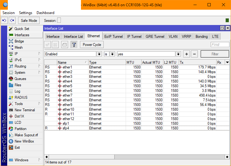

An other way would be to be able to hide all the disabled interfaces.
Just use filter with Enabled:yes and save the session…
And the comment before is not directed to you, but to a “generic user”… (and sorry for my bad english)
Example with sfp2 and sfp3 disabled:

However, it can also be used as a “Running” filter and DINAMICALLY only the connected ones appear.
Ah rextended, so what you are doing is strictly within the local winbox application.
If someone connected their laptop to the router and used their own winbox, all the interfaces would show correct??
