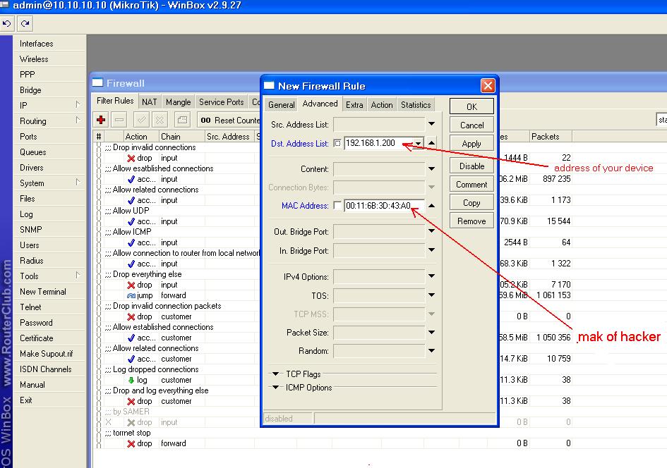

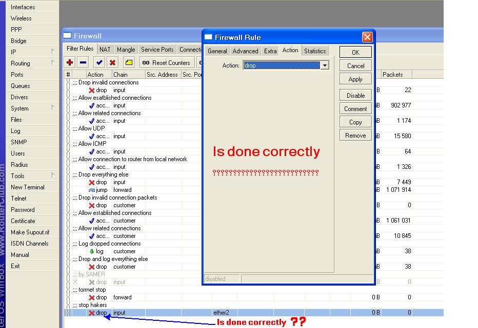

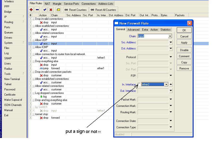

1-Please saw pictures attached … Are the settings correct???
2-I hope you tell me about The basic function of this rule ??and how to make sure it works properly

Yes that looks right to me.
Is ether2, the port that has been compromised?
Yes

It should work, the firewall is correct. The rule is correct. You did it right. The basic function of the rule is to stop access from the MAC of suspected hacker you have probing your network. You should not see the MAC of hacker show up if the rule is working. It sounds like you need a Mikrotik consultant to come and help you.
