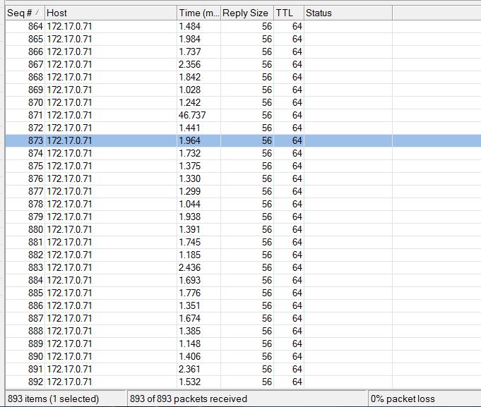

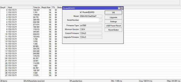

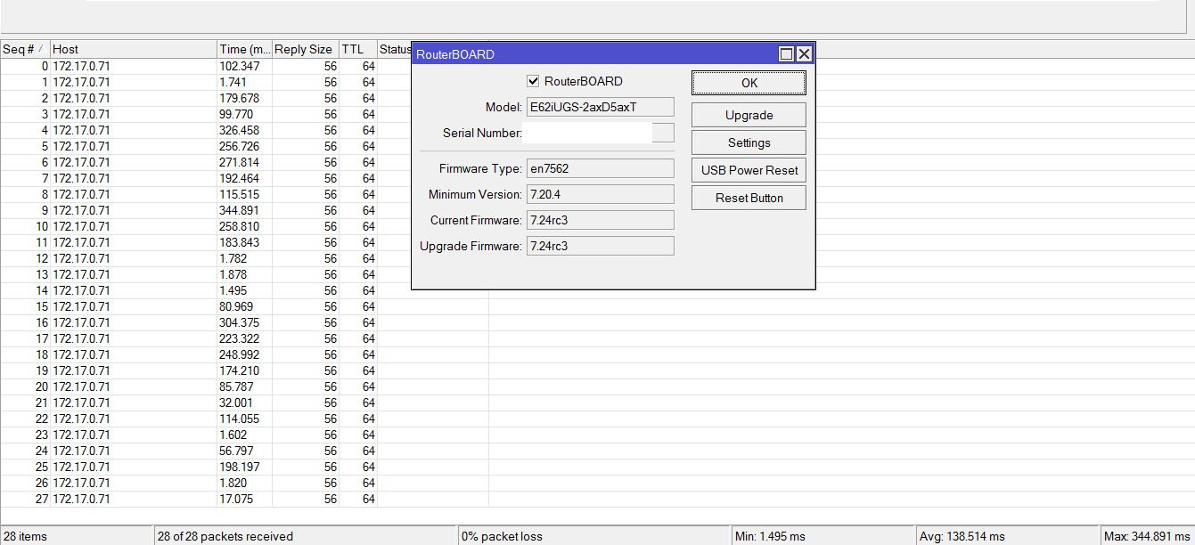

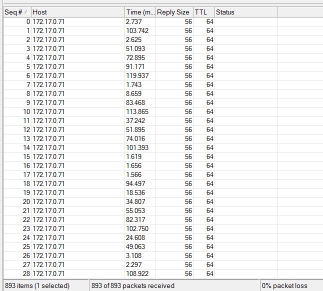

Symptoms: When pinging any wireless client (e.g., a smartphone connected to Wi-Fi) — whether from a PC connected via a wired Ethernet port or directly from the router itself (using the built-in ping tool) — the response time periodically spikes from 1–2 ms up to 100–400+ ms. Packet loss remains at 0%, but the latency is completely unstable. On RouterOS v7.22, this behavior was completely absent, and the ping was rock-solid (around 1–4 ms). Total network throughput is completely unaffected.

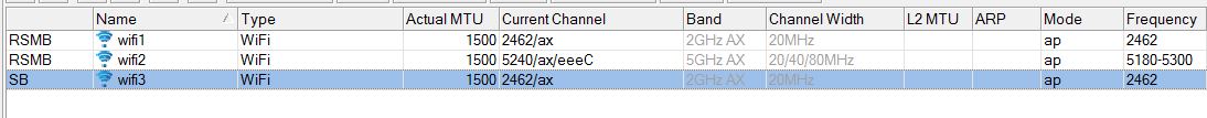

Attached are screenshots of the ping behavior and my active Wi-Fi interfaces.
