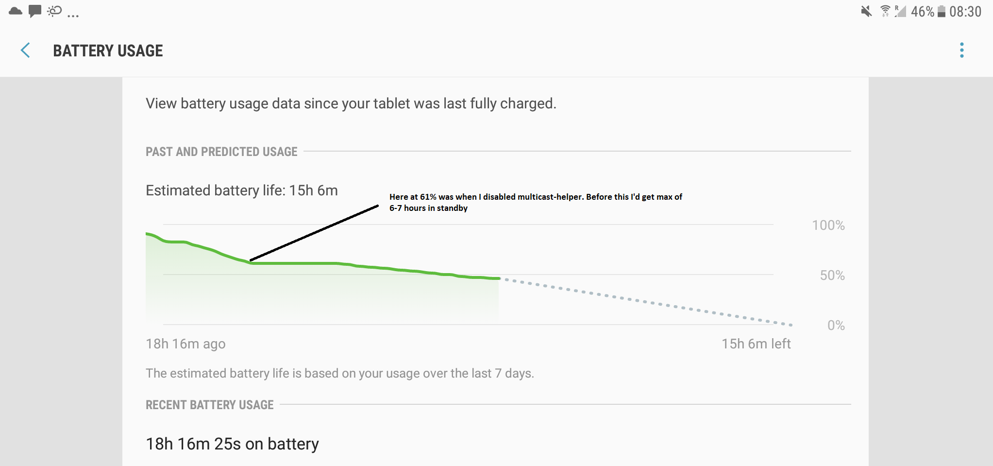

High Battery usage with 6.47 stable
Hi, my current setup is a hap ac2 as a capsman manager and cap and another router, a cap ac as another cap, i had both at 6.46.6, but this friday i updated them to 6.47 and stated to notice that my battery powered wireless devices, phones, tablets, stated to drain battery faster on standby, (on my s20, it went from ~ 0.8%/h to 4%/h, just sitting there). i had that problem at the beginning but fixed with keepalive-frames=disabled.
now, i reset my configuration and started again, i tought maybe some conf got corrupted, and the same thing, high usage.
Finally i went back to 6.46.6 and everything went to normal again, same low battery usage on standby.
i did not tested without capsman, i will try to, but if works ok as a ap, then capsman has a problem.
Anyone had a similar problem with the new stable version?
here are my 2 conf files

Multicast-helper causes higher battery usage. If battery life is a concern you might want to disable it.
I did try disabling it and it was the same high battery consumption. Also i don’t have that problem with 6.46.6. So it’s still a 6.47 problem.

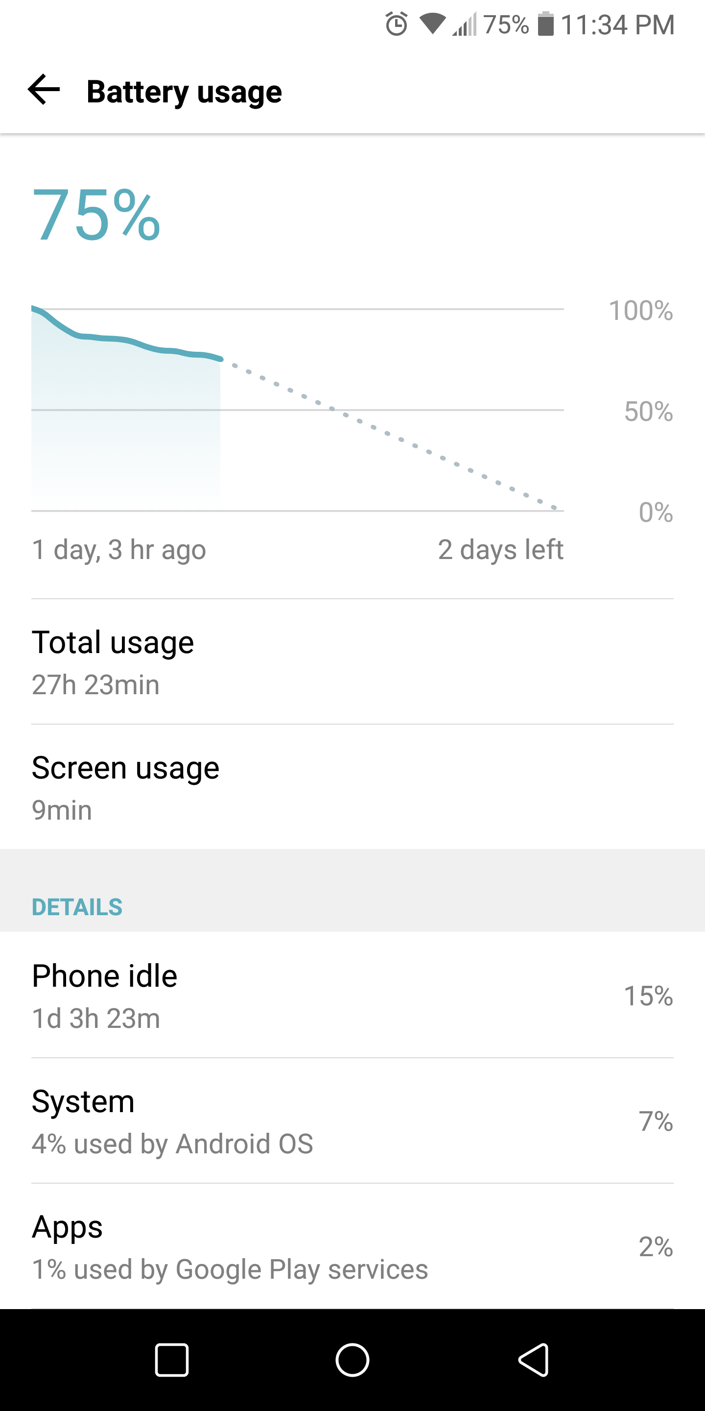

here’s a image of my phone battery stats, the slope is using 6.47, and when started to go more horizontal, its when I changed versions.

I was tearing my hair out trying to resolve this issue for some weeks on and off when I had time and last night finally had some success.
I have 1x hAP ac (master) & 3x hAP ac² being managed by CAPSMAN. I was primarily looking at another post http://forum.mikrotik.com/t/wifi-keeps-mobile-device-awake-keepalive-packets/62568/1 during my troubleshooting and seem to have overlooked some of the obvious comments in this post.
Strangely only my older Android devices were affected. A Samsung Galaxy Tab S2 and two Galaxy S9s were having obscenely short battery life (4%+ per hour in standby with screen off). When I was on holiday they would last for days on standby, so I knew it was definitely something to do with my local WiFi setup at home.
I even contacted MikroTik in case it was a known issue. It wasn’t a known issue but they were kind enough to give me some things to try:
  • Using band only-n or ac. (not an option for me as I have some older legacy devices on the network)
  • Disable keepalive-frames. (I tried this, no effect)
  • You could check if multicast-buffering has any effect on the issue, by default it’s enabled. (Not configurable on CAPSMAN controlled interfaces)
  • You could try enabling hw-protection-mode = rts-cts (I resolved the issue for me before I got to try this).
  • In wireless security profiles, don’t use TKIP. You could adjust the group-key-update time to be higher. (already wasn’t using TKIP, and from the other forum had tried a 1hr group-key-update time)
In the end for me it was indeed as mentioned here the multicast-helper set to “full”. I had initially enabled this as I was having discovery issues with my linked Yamaha MusicCast Soundbar and satellite speakers. After setting this to “disabled”, battery life on my Samsung Tablet was instantly improved.
I’ll gradually start rolling back the other things I tried now to see if it remains the same (turn on keepalive-frames again, set group-key-update time back to normal).
Hope this helps someone else!
