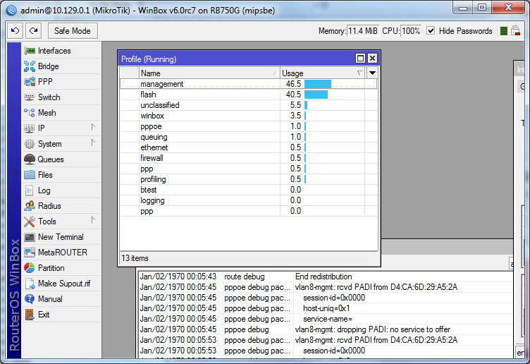

When pppoe-client runs over ethernet interface, everything works just fine. Unfortunately, when pppoe-client runs over a vlan interface, the mikrotik experiences the following issues whenever there is significant load (>3mbit) on the pppoe-client interface:
  • CPU load spikes to 100%
    Flash usage spikes to 60 %
    Mikrotik continues to respond to icmp pings
    Winbox, web, stop responding until traffic is removed
    Mikrotik eventually locks up/hang if traffic doesn’t stop

addAfter enabling full logging to memory, I’ve noticed the following in the log shortly after high traffic on the pppoe-client:
00:23:50 system,info log rule changed by admin
00:25:14 store,debug web-proxy1: disk setup finished successfully
00:25:14 store,debug activating store for web-proxy1
00:25:14 store,debug web-proxy1: activation finished successfully
What the hell is web-proxy1 doing? It should be disabled!
