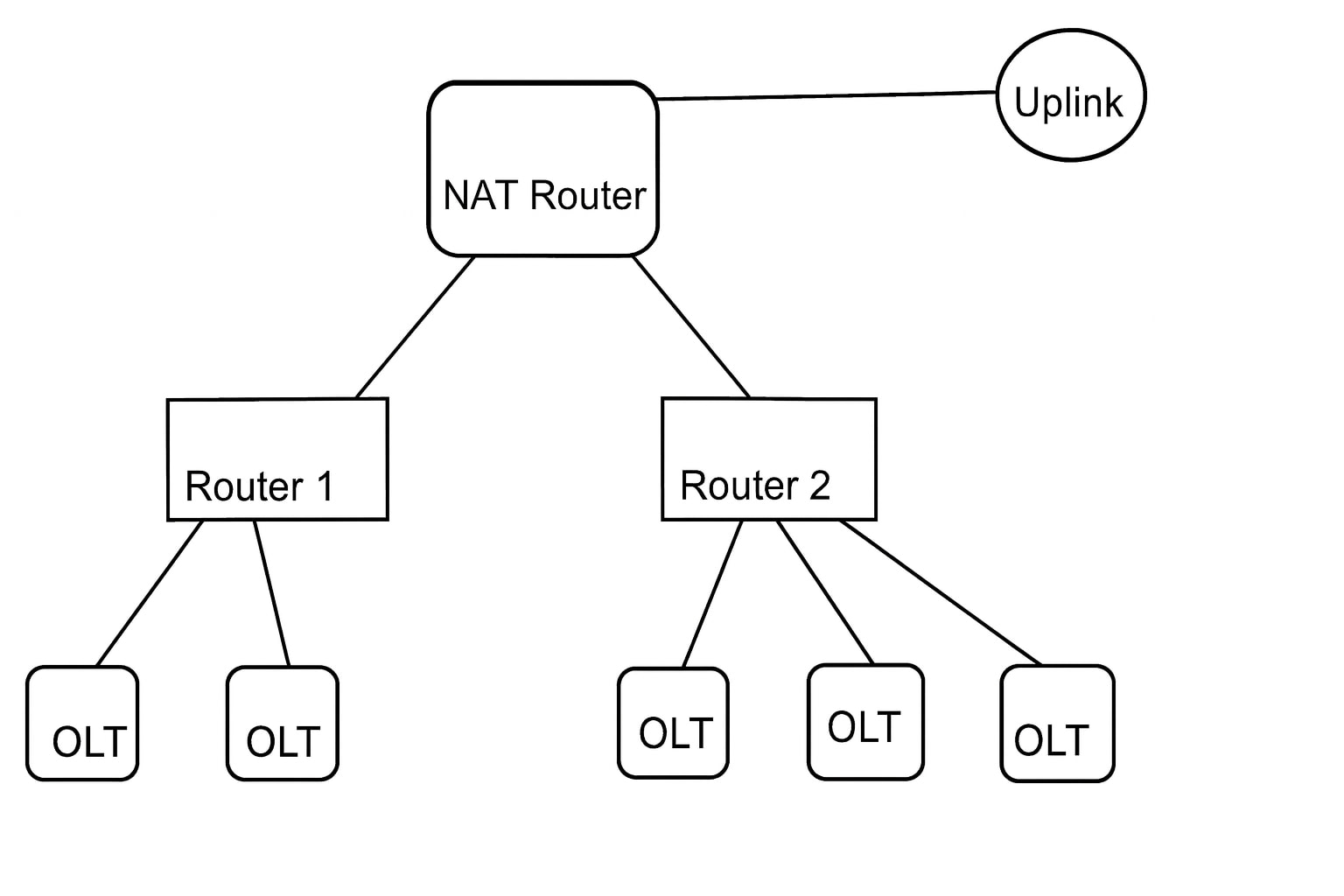

I have a MikroTik CCR2216 setup with the following configuration:
Two CCR2216 devices are used for PPPoE, each handling approximately 3000 customers.
NAT is managed by one CCR2216.
Issue:
I am experiencing high CPU load (>70%) on the CCR2216 that is handling NAT, which is impacting performance.

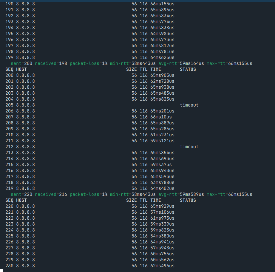

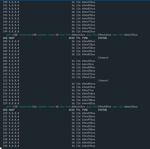

I am looking for a solution to reduce CPU utilization. When CPU load increases, I observe packet loss and ping timeouts, which indicate network performance degradation.
Yep, but - at the moment - you are failing to clearly describe your setup, your post is ambiguous, from what you wrote you may have:
  1. TWO CCR2216 devices in total, one managing 3000 users PPPoE and the other one managing 3000 PPPoE users AND managing NAT
  2. THREE CCR2216 devices in total, one managing 3000 users PPPoE, the second one managing 3000 PPPoE users and the third one managing NAT
  3. something else

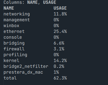

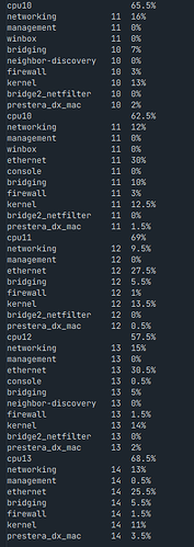

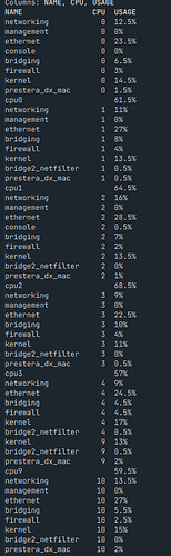

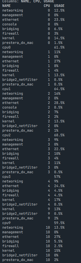

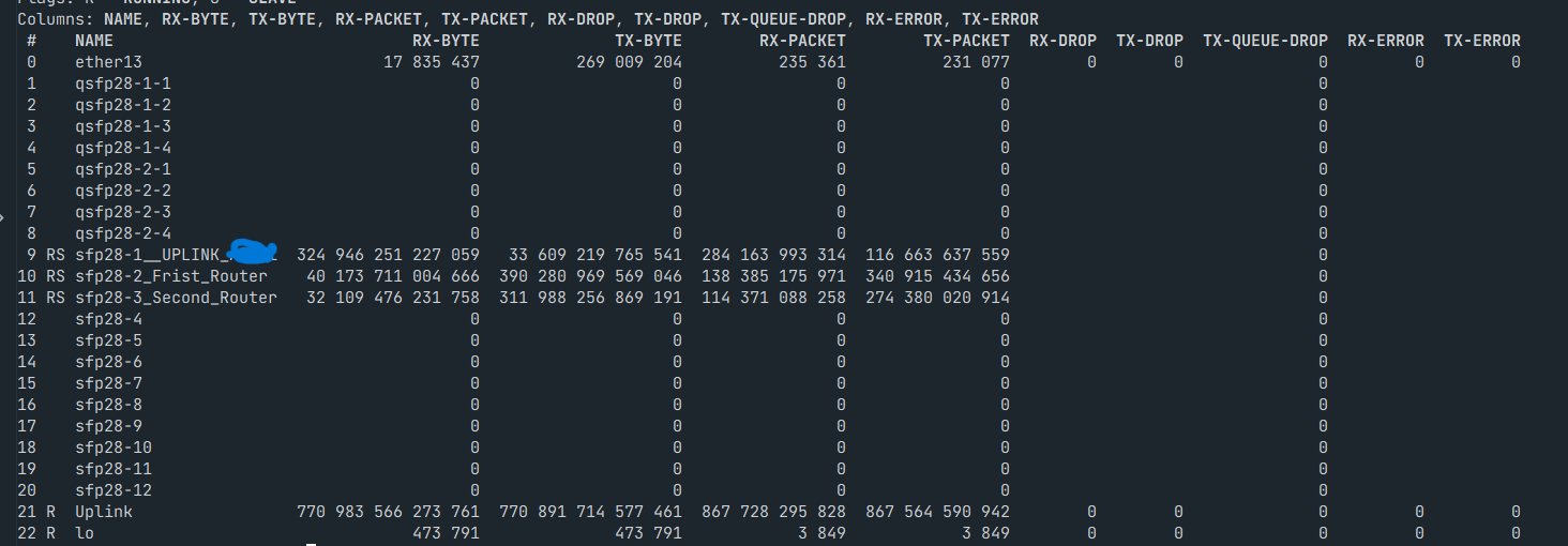

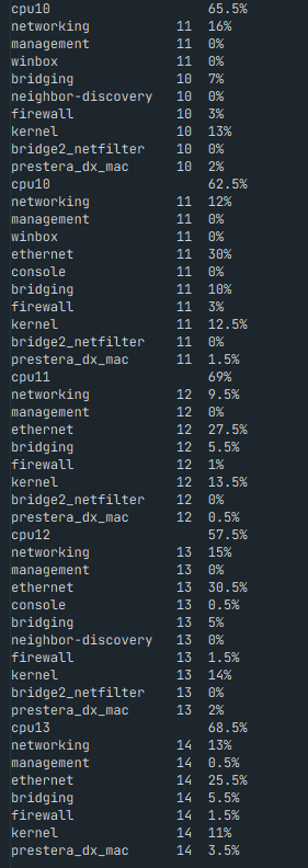

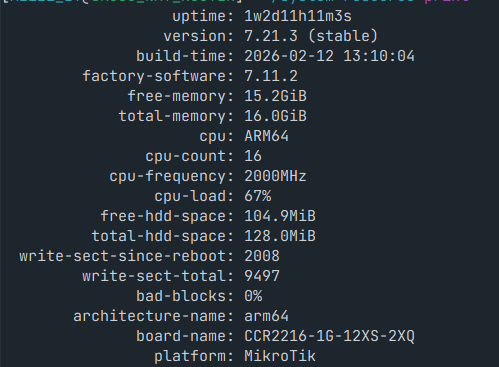

Show outputs under load on NAT router
/tool/profile cpu=all
/tool profile cpu=total
/system resource print
/interface print stats

When you test from internal network/user machine where is packet loss and ping timeouts, BRAS ,core NAT, uplink ?
Any fping / mtr output may help …

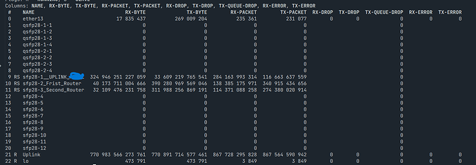

  • I have not yet done detailed customer-side ping checks.
  • When I do test during peak hours, I see some ping timeouts (packet loss).
  • My uplink capacity is 25 Gbps, so the issue is not due to uplink overload.
  • FastTrack is disabled. I tried enabling it once, but it caused problems — some customers experienced reduced download and upload speeds.
