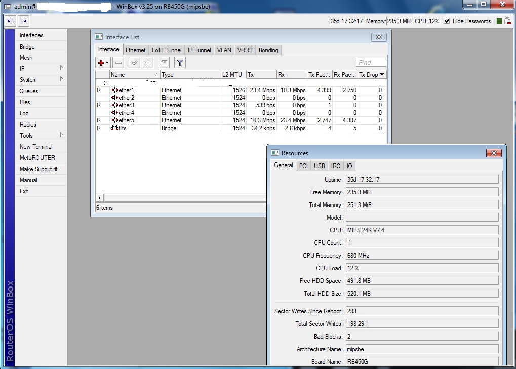

Hy, a few days ago i bought a RB450G routerboard
The problem is the CPU load. On the most part of the time is up to 100 %. No TCP SYN flood, or UDP.
NR of connexions: 15000 (total ip’s conected to the router from outside.“PS: I have hub hosting”)
Trafic: 40 Mbps
Configuration: eth1 - Internet provider
eth2-5 bridged togheder and share /24 ip class
No firewall rule added or queues.
Or 2000 connexions
Trafic 5 Mbps =>>CPU 40 %
When the CPU is 100 % i have imense lag, even local ping failures.
Is it normal ?

The capacitors are fine but de LEDs from every port is lightening verry slow, when cables are unplugged.

Tested the router again after upgrading… Still the same thing. I think the router doesen’t suport huge number of simultaneos connexions. Sorry but mikrotik is a bad idea and not good.
using abstract values like “huge” wont help you solve the problem you are having. What is huge, maybe for that load you should have gotten RB1000?
Huge = 20.000 unique ip connexions in rush hour and bandwidth 50 mbps.
For example a hosted hub requires an ip. And that hub have’s for example 300 users, that means 300 ip’s that router have to maintain and forward to hub ip. A hub with 300 users,consumes 30 KB /s
Now i have the following configuration
two bridges
bridge 1 - ether 0, ether 1
bridge 2 - ethet 2, ether 3, ether 4
Provider internet cable → ether0 - > out to server eth0 via ether1
Out from server via eth1 - > to router ether2 → out from router to server 2 via ether 3, ether 4 and 5 to clients.
I’m using firewall on bridge interfaces and queues.
The procesor stays below 60 % when is rush hour and 40 mbps bandwith on upload, download below 10 mbps
Why doesen’t work with initial configuration ?? (provider - > router with dhcp configured /24 class) the trafic is the same. :frowning:
