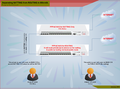

Only If you have high number of ppp clients & you are doing NATTING as well, then I would recommend you to do NATTING on different router.
Example:
Mark connection for private ip users, and then route them to 2nd router which will do the NATTING. also add reverse route in 2nd router so that it can see the users ip directly.

This is a quote from the thread I linked, please read it.
It doesn’t matter if the user has public or private IP, it’s about interfaces.
When interfaces connect/disconnect, with combination with NAT, it gives you high CPU usage.
So simply eliminate NAT from that router.
Have a separate router “in front” of the PPPoE concentrator, that NATs the traffic from the private IPs.
Setup routing (even static routes) between the PPPoE concentrator and the new router.
Terminate public and private IPs on the PPPoE concentrator.
That way, you will not have CPU usage issues.
It is not just a matter of NAT, it is a matter of connection tracking as a whole. All connections running through that interface, nat’ed or not, are removed from the conntrack table at once when the interface goes down.
