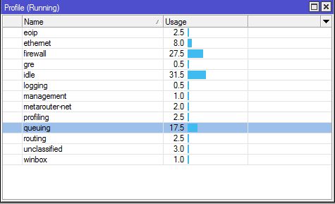

here is a extract on tool-> profile
NAME USAGE
ethernet 7.5%
console 0%
eoip 3.5%
firewall 21%
metarouter-net 0%
gre 0%
winbox 0%
management 2%
telnet 0%
idle 53.5%
profiling 1%
queuing 9.5%
routing 0%
unclassified 2%

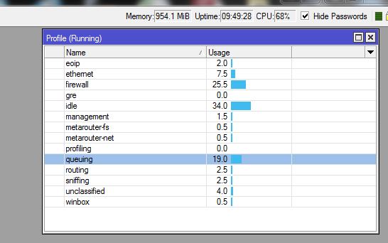

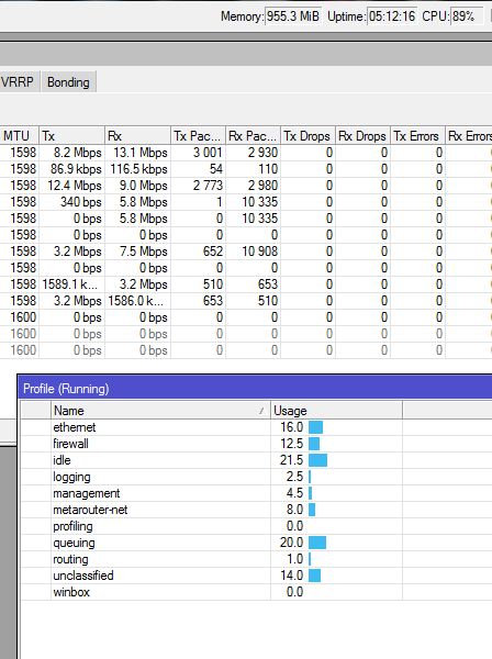

If you see the screen shot, between 15 & 20 % is being used for queuing, but we don’t have any queue’s on our RB.
You are probably seeing queuing because of inherent interface queues.

We still experiencing the High CPU load, see the screenshot.
Still not helping, isn’t the RB1100Ah supposed to a hi power router?
I disabled the Meta router now, CPU load dropped from 30-40% down to 5-20%, so clearly RB1100AH is not powerful enough to run a Metarouter to our requirements.
Well, only creating a Metarouter (but not running it) already doubles CPU usage for any amount of traffic running through.
I suppose, that is because there is an invisible bridge being created, where the physical and virtual ethernet ports are then attached, so there is an additional forwarding decision to be made for each packet running through the router.
It’s pretty noticable on RB1000/1100 Routers. I have a RB1000 with about 350 Mbit/s of traffic flowing through. Without Metarouter: ~25-30% CPU. Metarouter created, but not running: ~60-70% CPU. Metarouter running (and pushing like 2-3 Mbit/s of traffic): ~80-95% CPU.
