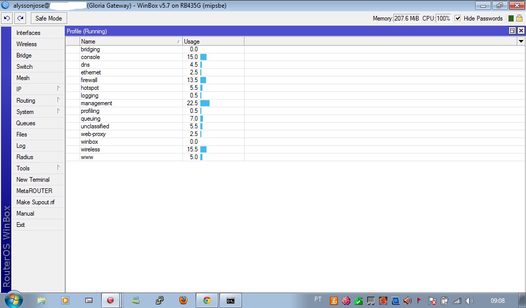

I´m with a little problem that i can´t figure out how to solve this. I have a routerboard 435G (was a 433AH before, changed to see if solve the problem, but no sucess) with Hotspot and DHCP, and his CPU is always on 100% of usage, i’m using a MK v5.7 now (upgraded from 4.17, it was with the same issue on v4.17). i’ve upgraded to use Tool > Profile and see where’s my CPU usage goes, Console and Management its always at high lvl of usage, how can i solve this problem, any ideas?

So, as i said before in tool>profile says me that Management and Console are on high lvls of usage, i will post a print.
We have Wireless, Firewall and Queuing use good part of, but these i know what they are, how can i solve this?
Upgrade to 5.8, there has been issues on 5.7 in regard to 100cpu usage if dhcp server is enabled. Also make sure the firmware is update. Than test again..
