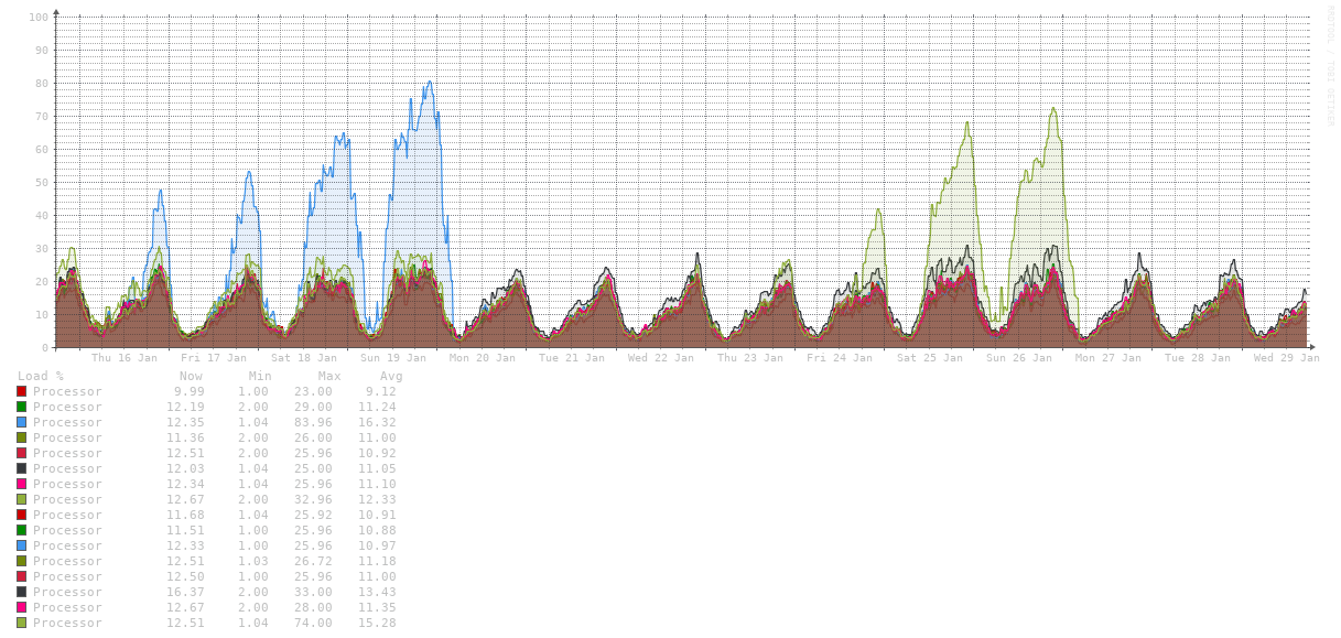

All this time, 3-4 days after the reboot, which has to be done once a week because of this, there is a gradual loading of 1 core, with an increase to a peak close to 100% threshold. This problem persists starting with version 7.15 during the initial installation, and ending with the current 7.17
Below is the CPU load graph (few month)

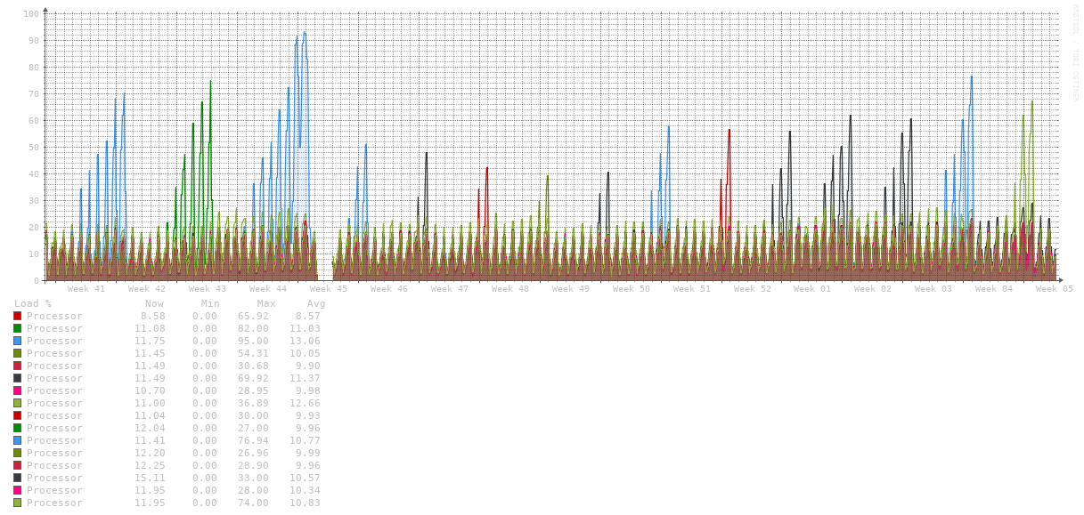

few days

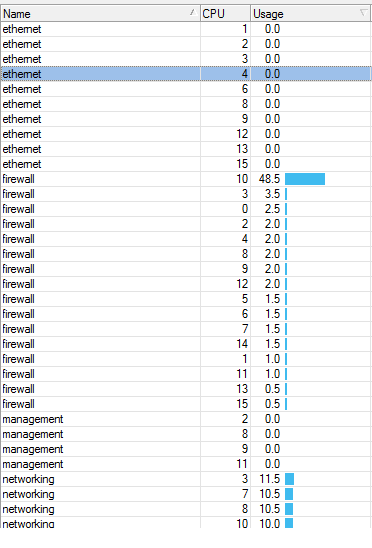

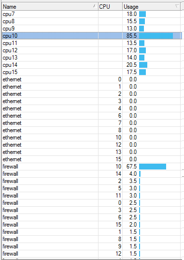

What does Profiler show?

I found a possible reason, but I didn’t understand why it was happening gradually, as an accumulation effect. It seems to be related to the connection tracker. I have used the script to clean up old connections several times, for which there was no activity for more than 60 seconds. And it showed a sharp drop in load. But what is more interesting is that the load is initially distributed across all cores, but then it seems to fall on one core and stops parallelizing. Perhaps this is a failure of the internal load balancing logic. The strangest thing is that this happens only ater 3-4 days and is increasing.

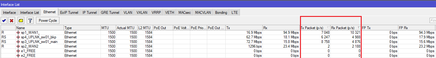

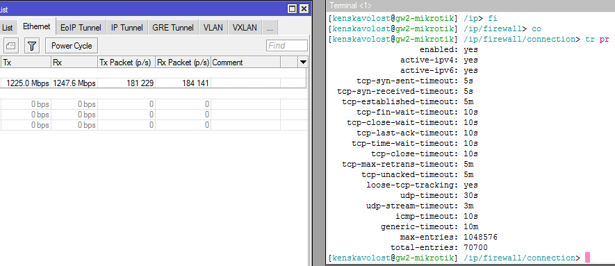

look at: rx/tx p/s in interface menu
/ip fi fi pr co
21

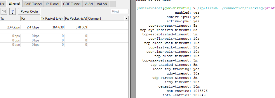

check actual connections with
ip/firewall/connection/tracking/print
/ip fi co tr pr
IMO your post would be much better if you used full commands and properties instead of these obfuscated code snippets. If not for other thing, these snipets might stop working if some future ROS would add new configuration branch/command with name beginning with same two characters as existing branch/command.

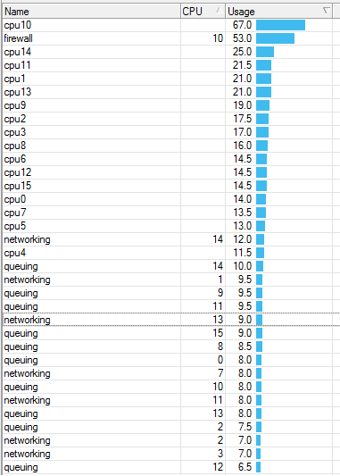

I’ll take the data at peak load later in the evening.
Peek time
