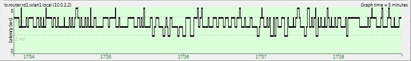

1.5km PtP nv2 bridge with 2x SXTG. This is 5 minutes of ping, average ping over 5 minutes, 3ms.
SXTG’s are in WDS bridge, pings are performed from routers that are behind both SXTGs. ROS 6.1.
Same result with or without other traffic running on the link.
