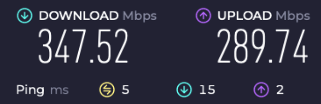

If I go to www.speedtest.net and test my internet speed I get this result:
However, if I plug the server directly to the modem I get this result:
I’m totally new to the Mikrotik OS and honestly don’t know what else to do to get the correct speed with my server connected behind the firewall. Attached is my configuration file. Please take a look at it and let me know what I can do.

CRS devices are not routers, they are switches (regardless the marketing BS name which includes Router). Yeah, since they run ROS, they can route, but at shitty throughputs. And you’re getting what is realistically expected.
Now, the device does support L3 HW offload, so it can do some of functions at wirespeed, but it has to be configured very carefully (and from a quick glance at your config it’s not really close). Document about L3 hardware offloading may clear a few things for you.
JFYI, the usual parameter suggested on the forums to evaluate a Mikrotik device speed in routing is the 25 ip filter rules with 512 bytes packets, that for your device:
https://mikrotik.com/product/crs312_4c_8xg_rm#fndtn-testresults
is reported as 169.6 Mbps, and this is - understandably - with a “perfect” configuration, so you are not very distant from that.

Thank you very much. That’s what I was suspecting.
For now I’ve done some tweaking in my network. There was a Synology backup unit which was using most of the bandwidth (despite having it set to use only half of it). I moved it directly to the modem (or first firewall if you like) and CPU usage went down from 100% to 2%. That is helping a little bit.
