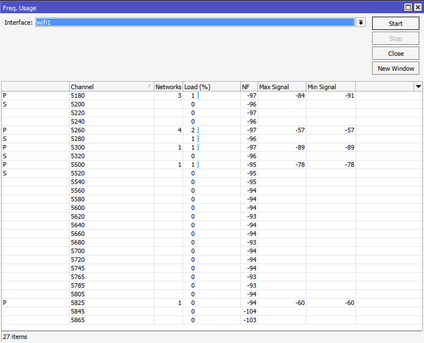

  • Only the 5GHz radio is enabled, and I’ve chosen a less occupied channel (120) based on a frequency scan. In addition, channel width is set to max 40 MHz. Generally, the channel selection and width did not seem to have much of an impact for this particular problem. Most WiFi-related settings are at their default values.

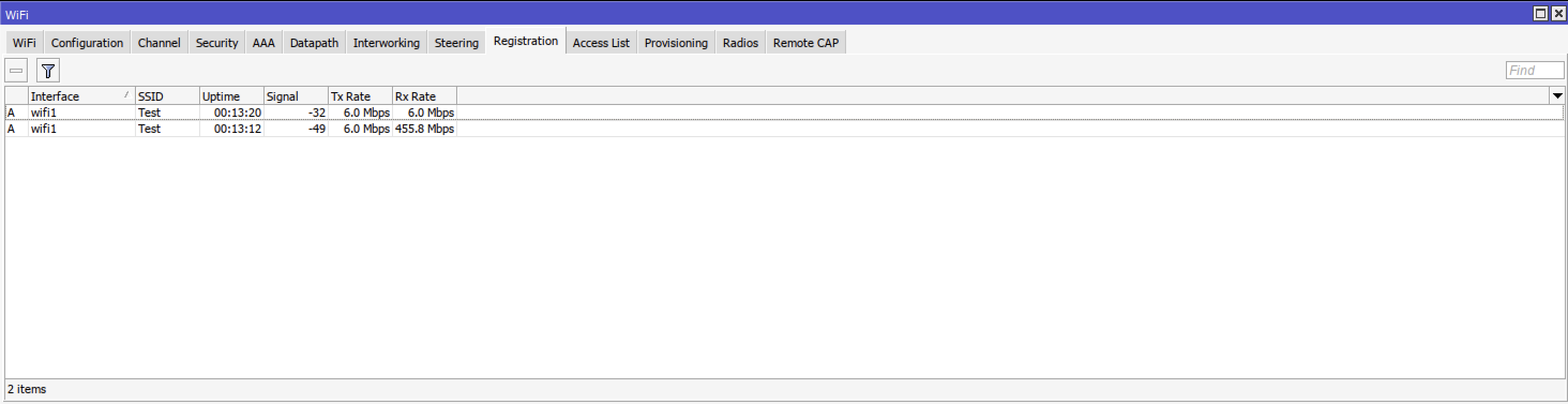

  • Two mobile devices (an iPhone SE and a Samsung S22) are connected as clients, distance from hAP ax2 about 50cm, line of sight. The devices were not sleeping during the test.

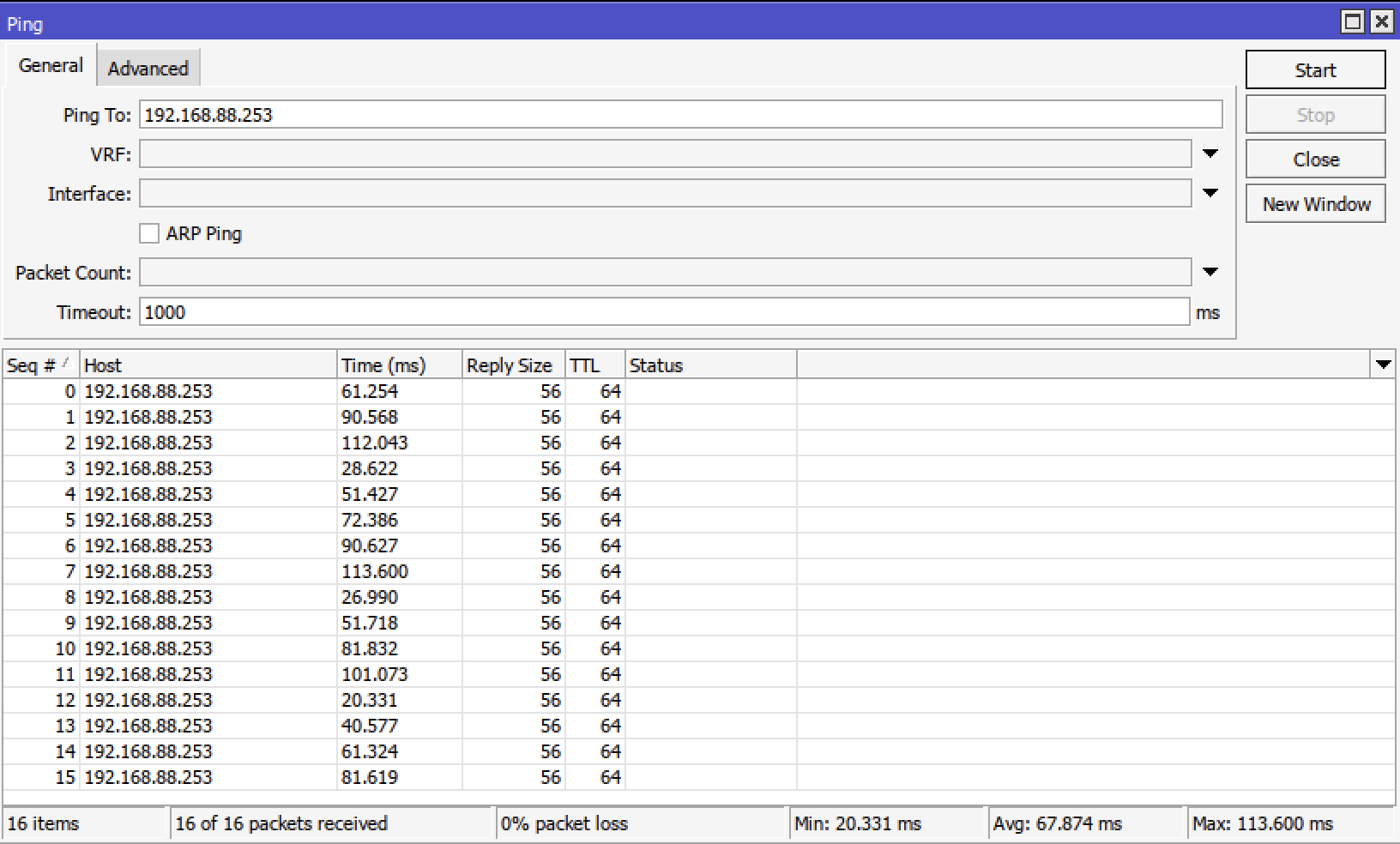

  • When I ping from the hAP ax2 to either device, I observe overall bad latency and intermittent spikes.

Any ideas what might be the problem?
