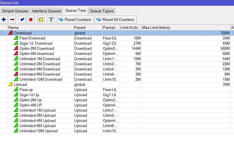

Queue Tree works on one CPU. If there’s heavy traffic, this CPU get 100%. It’s better to find a way using Simple Queues, so the workload is balanced over different CPUs.
Please, post your config and what do you want to achieve, maybe someone here can optimize it.

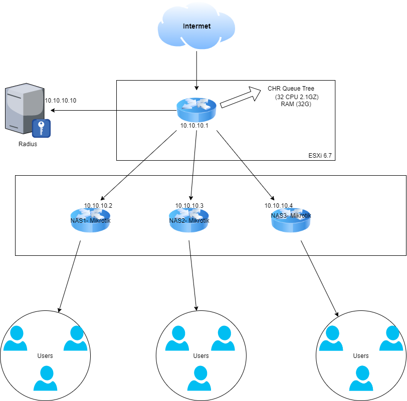

CHR connected to a group of NASs (all are Mikrotik), they acts as a pppoe server on our network, 2000 active subscribers.
Queue Tree (PCQ) configured as the image 1 :
and below is the diagram:
