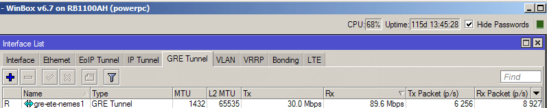

Try look on the IPsec. We have many 100 Mbps GRE/IPsec tunnels between RB1100AH/AHx2 routers without problems. They are limited with 100 Mbps Ethernet paths (if I remember the GRE/IPsec tunnel between two RB1100AHx2 runs around 250 Mbps on the 1 Gbps network with AES256/SHA1 proposal).
