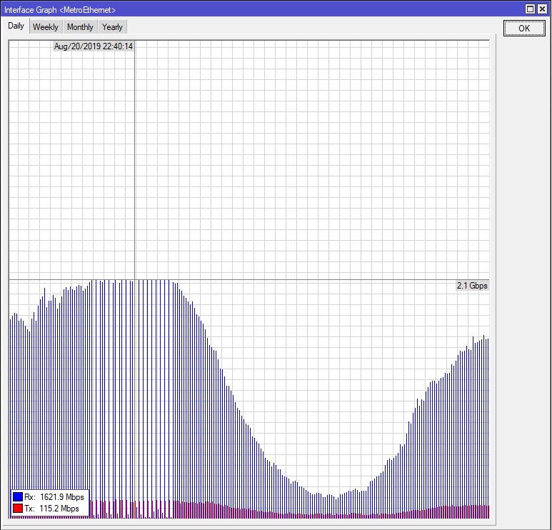

I try 6.43.8 and 6.45.3. When the traffic over 2100 mbps, graphing gives error. Picture shows the error.
Yep, that’s an old thing with Winbox. It works fine on the web GUI, but not on Winbox. I usually do the graphing on an external solution, like Zabbix or Observium, and that’s what I think it’s the best solution.
