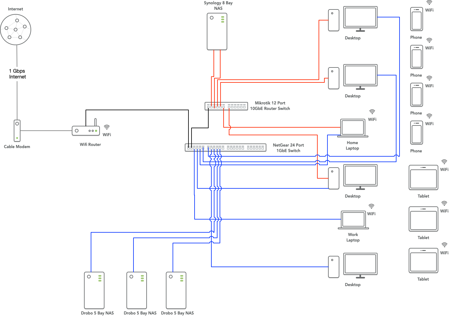

I recently purchased the MikroTik 12-Port 10G Switch with Dual Power Supply (CRS312-4C+8XG-RM) and have added it to my home network. I already have a 1 Gbps Cable Modem, Wireless Network Router, and an existing 1 G switch (Netgear) that I bought several years ago. The intention of adding a 10G switch was to have a higher bandwidth network for a NAS (Synology) and have my multiple family computers use this as a fast backup/restore channel and also for file sharing, VM access.
Overall It is working fine, but I was wondering (as a bit of a network newbie) as I have the MikroTik Managed Switch connected to the existing Netgear 1GB as an uplink and I’m able to have systems connect to it but sometimes the connection goes over the 1 GB network. Is there some simple way (perhaps by subnetting or setting up static routes) to have specific applications (Acronis Backup) use the 10 GB network first in terms of priority?
I’d also like avoid having any traffic for this NAS go over the 1 GB network or the WIFI if possible.
Its my first foray into a more advanced network configuration so apologies for the newbie questions…

Thanks for the response. My primary concern is is to isolate traffic between internet access/video streaming and Backups/File Sharing to a new NAS.

Yes. Three desktops (and one laptop) are connected via the 1 Gbps switch and also to the 10 Gbps MikroTik through a Thunderbolt-10GbE adapter. My plan is to have dedicated bandwidth so they can share files and do backups quickly to a larger NAS (~80 TB) while keeping this separate from internet traffic for internet browsing, email and video streaming. I’m slowly transitioning away from several Drobo NAS appliances to a Synology NAS as I’ve had very unstable backups and one of the Drobo’s are quite old and starting to fail.

There isn’t a problem and I’m seeing great network performance for the systems connected to the 10GbE network. I’ve also configured the 10GbE interfaces to the the first on the network priority list and the 1 GbE to be second. This works appropriately, but just wondering if there is a way to keep the 10GbE isolated so that when I access the internet to stream video, it goes over the 1 GbE network not the 10 GbE network. When one of my systems does a backup or accesses files on the NAS, it uses the 10GbE network. The systems appear to be have the horsepower to handle that performance.
I’ve attached a draft network diagram. The red lines indicate the 10GbE network while the blue lines indicate the 1GbE network. I could get more details on the IP network but it uses DHCP so each can vary. I try to use my router to “pin” devices by MAC address to known IPs where possible, but it will take me some time to pull this together.
