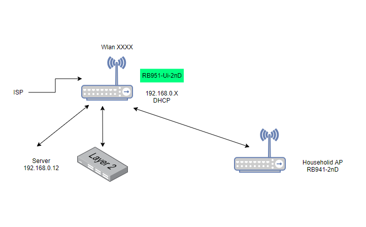

Heloo friends. I have RB951 for me and my servers ( VPN, future DNS cache, NAS ) in network 192.168.0.1. RB951 is set up as “Home AP”. Now I would like to separate and change location of my AP device ( problem with signal coverage ). I Buy RB941 and want to connect it on RB 951. I pluged RB941 to RB951 and set RB941 as “Home AP”.and put it in 192.168.0.2 range. My problem is: I cannot see RB941 on my network when connected to RB951 WiFi or over cable. I know firewall rule is problem and can someone point me in right direction.
Problem is next: I use VPN server ( VM ) to access my network and cant conect od WiFi of RB941 to manage settings, so I need option to access it via winbox like RB951.
Or someone can suggest better config.
