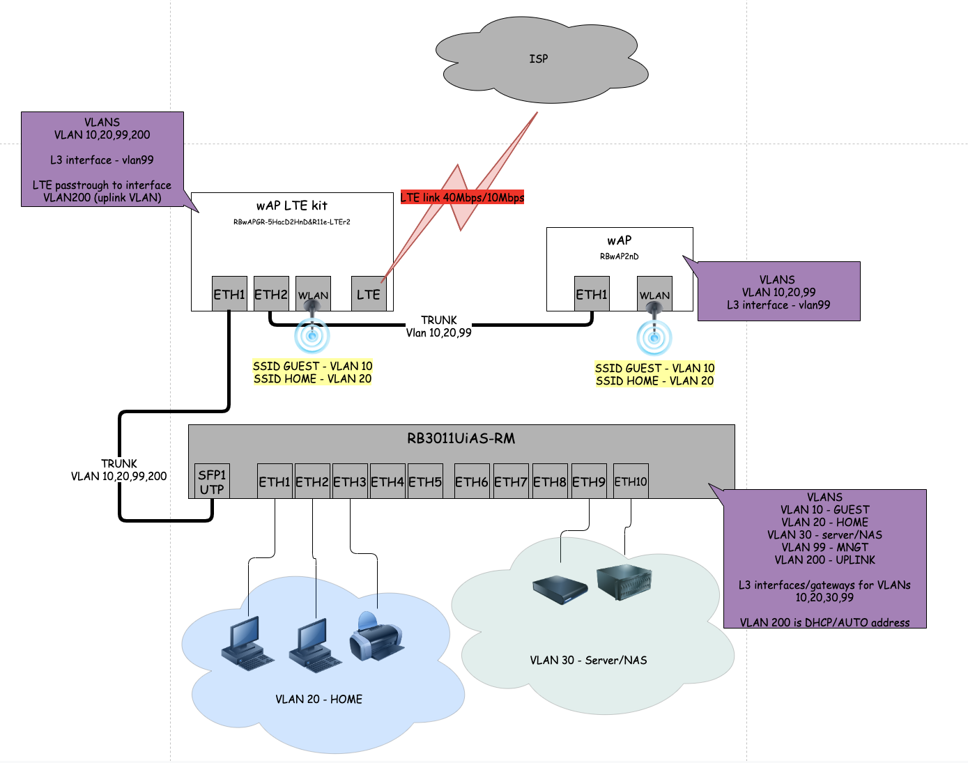

I’m making a new network with three Mikrotik devices. I have no DSL/FTTH connectivity so I have to use LTE capable device.
Here is my network diagram. I come from Cisco/Juniper environment and I’m quite confused regarding the right approach to configure VLANS and BRIDGES etc..
I tried following some howtos, but I couldn’t get vlan99 connectivity between devices.
That’s what I want to accomplish..
If you could give me the correct interface just for VLAN99 i think that i can figure out the rest.
Thank you.
Alex
See item C. here → https://forum.mikrotik.com/viewtopic.php?t=182373
