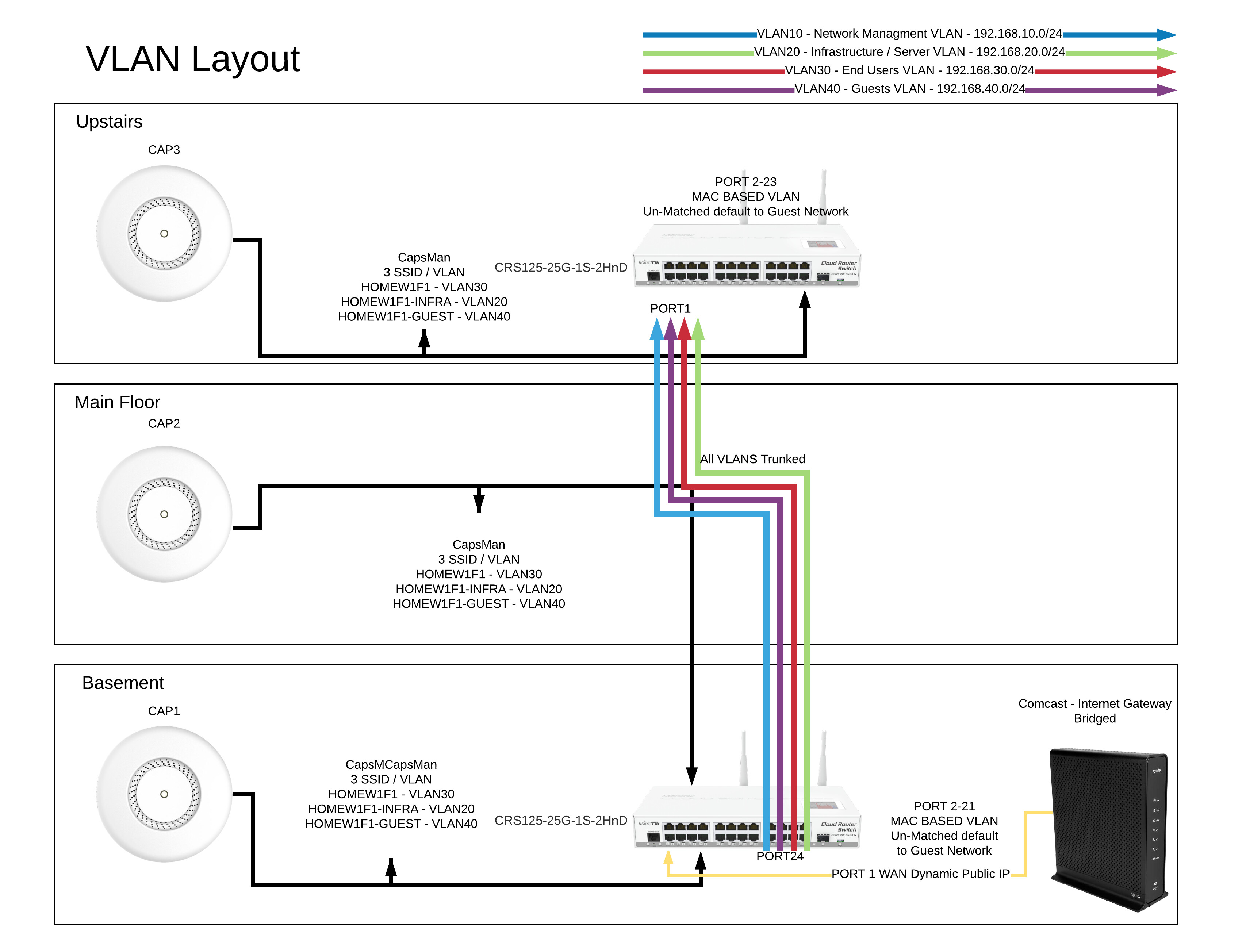

Hey forum… I’m tired of figuring it all out for myself to just feel like I made something functional that’s full of mistakes.
At this point I want an expert to review my configuration for sanity and to correct my mistakes.
I love mikrotik but with much power/features comes the need of great knowledge.
I’m willing to pay to play and have some desired features I want implemented.
I have the following diagram explaining the hardware involved and the desired configuration high points:
I have three cAP AC units and two CRS125-25G-1S-2HnD units.
I want to have 4 vlans as shown in the diagram.
I want to make sure all the “access” ethernet ports are mac based vlan’s that don’t have to be tagged for a specific network and if the mac address isn’t matched that it will default the user to the guest vlan.

I want to make sure all the “access” ports are mac based vlan’s that don’t have to be tagged for a specific network and if the mac address isn’t matched that it will default the user to the guest vlan.
Why Mac used?
Why not SSID-Based?
I guess I wasn’t very clear. SSID based VLANS for wifi and mac based for ethernet.
I’m no expert (I come here to learn generally rather than to advise), am a long way away from being able to take on paid work and am just as likely to be corrected by the next expert that comes along, but I don’t understand the need for all of the bridges in your VLAN configuration. My understanding was that best practice for switch chip based VLAN’s was to have one bridge and for routing purposes between VLAN’s to add VLAN interfaces to the bridge.
With the single bridge you maintain HW Offload and so get the best possible switching performance without stressing the CPU. Something like this -
/interface bridge add comment="Bridge For Switch Chip HW Offload" name=bridge1 protocol-mode=none
/interface vlan
add comment="Internal Zone" interface=bridge1 name=vlan100 vlan-id=100
add comment="Second Zone" interface=bridge1 name=vlan200 vlan-id=200
add comment="Guest Zone" interface=bridge1 name=vlan300 vlan-id=300
There are some really good examples for CRS125’s including one for MAC based VLAN’s on this page https://wiki.mikrotik.com/wiki/Manual:CRS1xx/2xx_series_switches_examples#MAC_Based_VLAN. You will probably want to combine the MAC based VLAN example with the InterVLAN Routing example https://wiki.mikrotik.com/wiki/Manual:CRS1xx/2xx_series_switches_examples#InterVLAN_Routing if you are routing between VLAN’s.
The bridges were to allow the internal wifi interfaces to be able to bridged with the vlans. I don’t know of a better way to do that. In others example I’ve seen it a common practice to add a vlan interface as a sub interface of an ethernet port that uses the switching chip while wifi devices don’t use the switching chip and have to be bridged in a grouping with the vlan interface.
