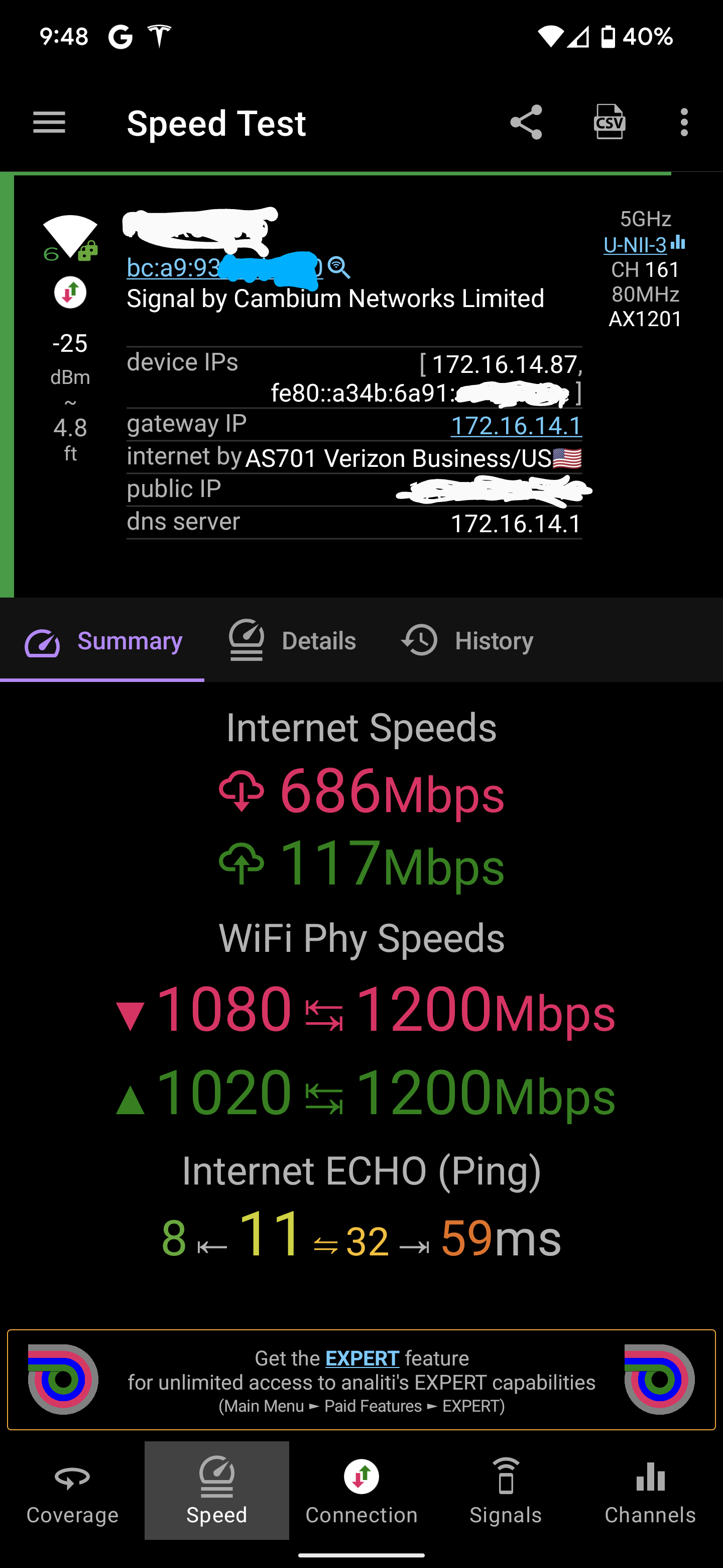

Which would be fine as that’s the kind of speeds I get here sat here right now under a VERY expensive Meraki access point with a 1Gbps backbone. But I’ve never seen >200Mbps with the Meraki access points.

I happened to still have the remote session open at 1am before I went to bed - got well over 200Mbps and even hit 300Mbps once. Nobody else was using the network. This suggests that the problem is not specifically to do with the cAP ac themselves which is good to know. So keeps the finger pointing at either congestion over the air or performance of CAPsMAN when under load. As I part-time software developer, I can certainly accept that there could be performance problems in any bit of software. Mikrotik CPUs are good but not that good :slight_smile:

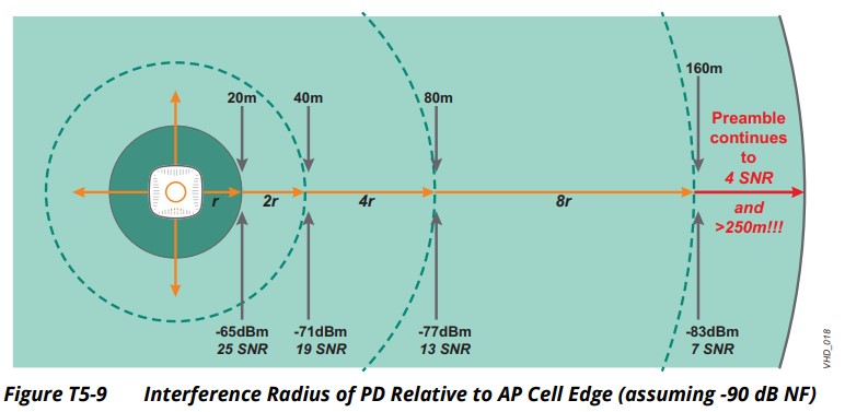

Co-channel interference is preferred. Adjacent (overlapping) channel interference is destructive, corrupting packets transmitted.
That interference goes further than the usuable range of an AP! If the (slow spead) header can be decoded, devices will wait, even if the (faster speed) message is not receivable.
