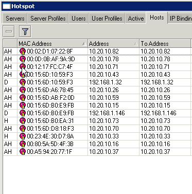

At the second place, clients using M2 are shown on the Hosts tab more than once:
[See IMG1 attached]
MACs: 00:15:6D:10:59:F3, 00:15:6D:B0:E9:FB
They are listed with two different IP addresses. IPs in 10.20.10.0/24 are the “correct” addresses. IPs 192.168.1.32, 192.168.1.146 are the client’s Computer IP address (IP which is supposed to be NATted so it shouldn’t appear here).

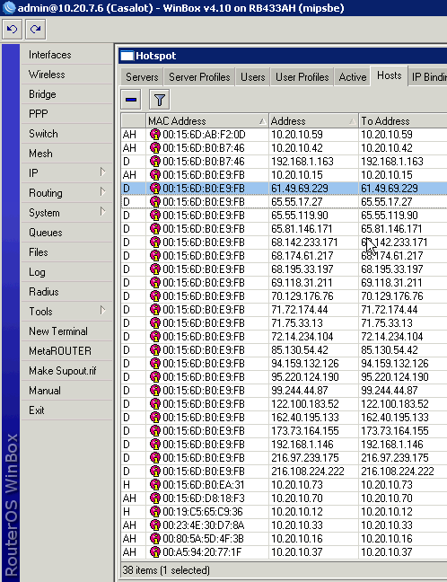

Sometimes things go mad and look like IMG2. Those public IPs are not from my network.
If I try to remove those invalid IPs they reappear almost instantly.
Client device is working properly. I have replaced them three times each (using new UBNT M2 every time) and I’ve run tests on that place (it’s right under my office) with another M2 with same results.
I discarded client configuration issues by comparing to Nanostation2 and to M2 installed in other places.
That problematic node is running RouterOS 4.10, right now, but I’ve tested using 4.11 and it didn’t change.
Another place with UBNT M2 as clients is running RouterOS 3.30 and it does not have any of these problems.
Any ideas?
