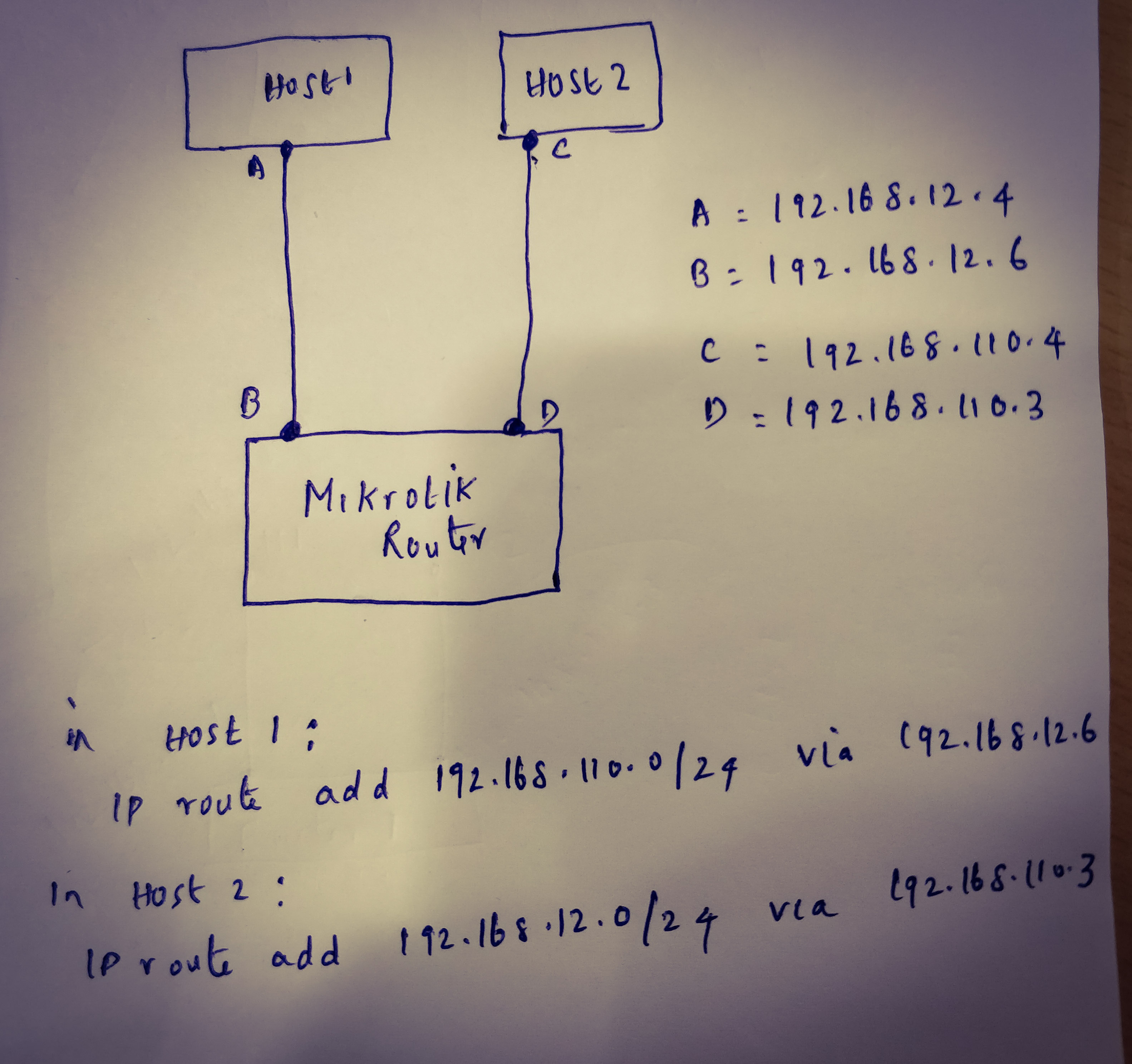

I am using one mikrotik router. Two hosts connected to it. I have attached the connection image. Its a simple basic connection.
Host 1 connected to Point B of Mikrotik Router .
Host 2 connected to Point D of Mikrotik Router .
Host 1 IP : 192.168.12.4
Host 2 IP : 192.168.110.4
IP of Router point B , where host 1 is connected to : 192.168.12.6
IP of Router point D , where host 2 is connected to : 192.168.110.3
No firewall policies , no routing rules , nothing..!!

So far it looks like there’s something wrong with routes on hosts. You have the routes written correctly in image, but check again if it’s really what you added.

In host1 , I have added route as :
sudo route add default gw 192.168.12.6 dev eth0
In host2 , I have added route as :
sudo route add default gw 192.168.110.3 dev eth0
Pls help.

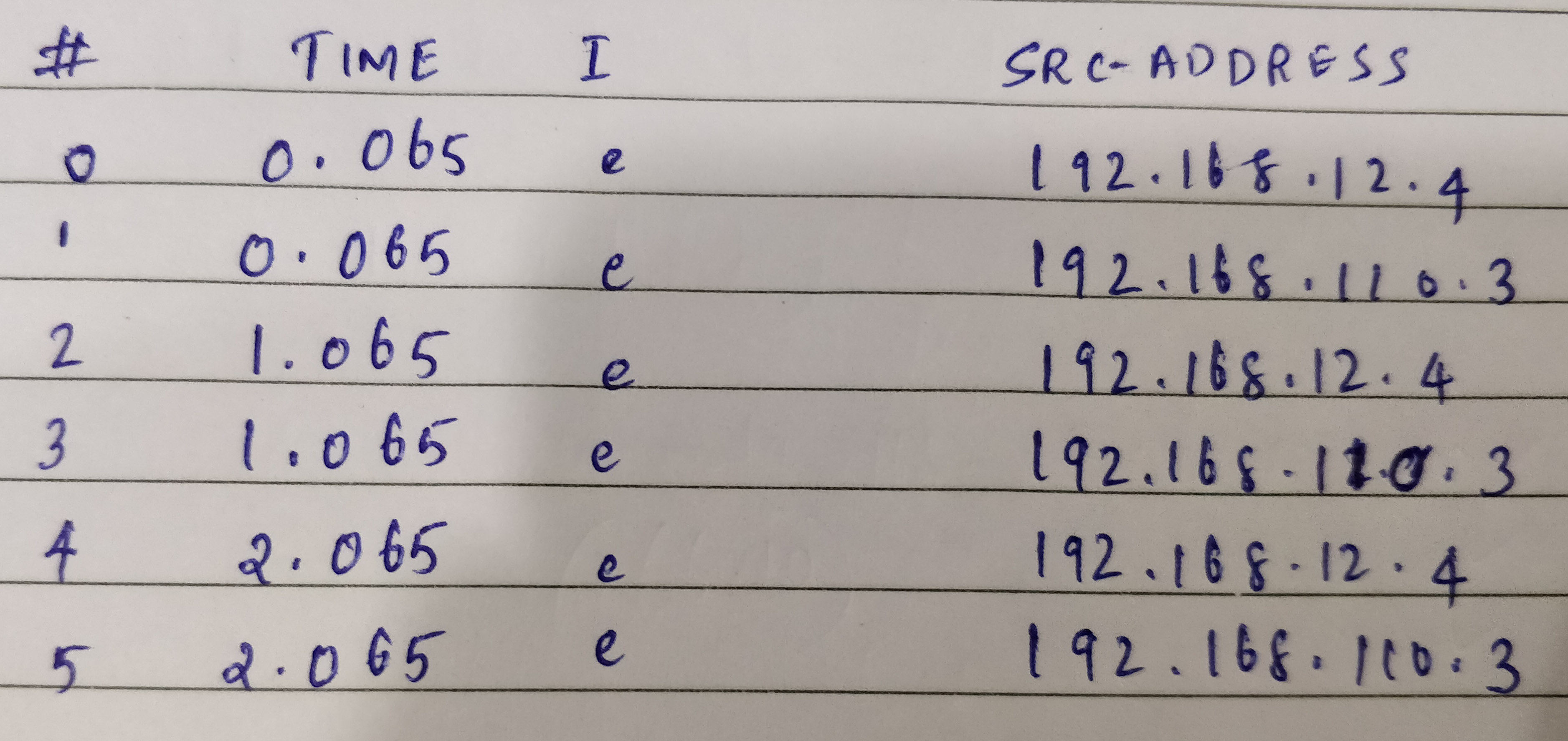

Pls find the 'tool sniffer packet print ’ of ether 1 , when ping from Host 1 to Point D is done

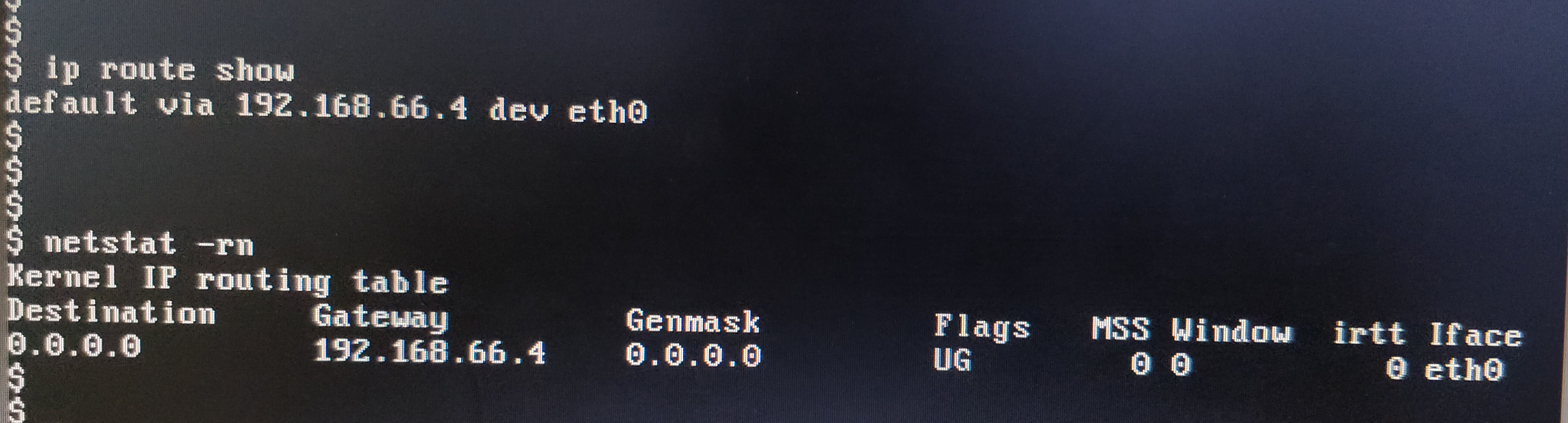

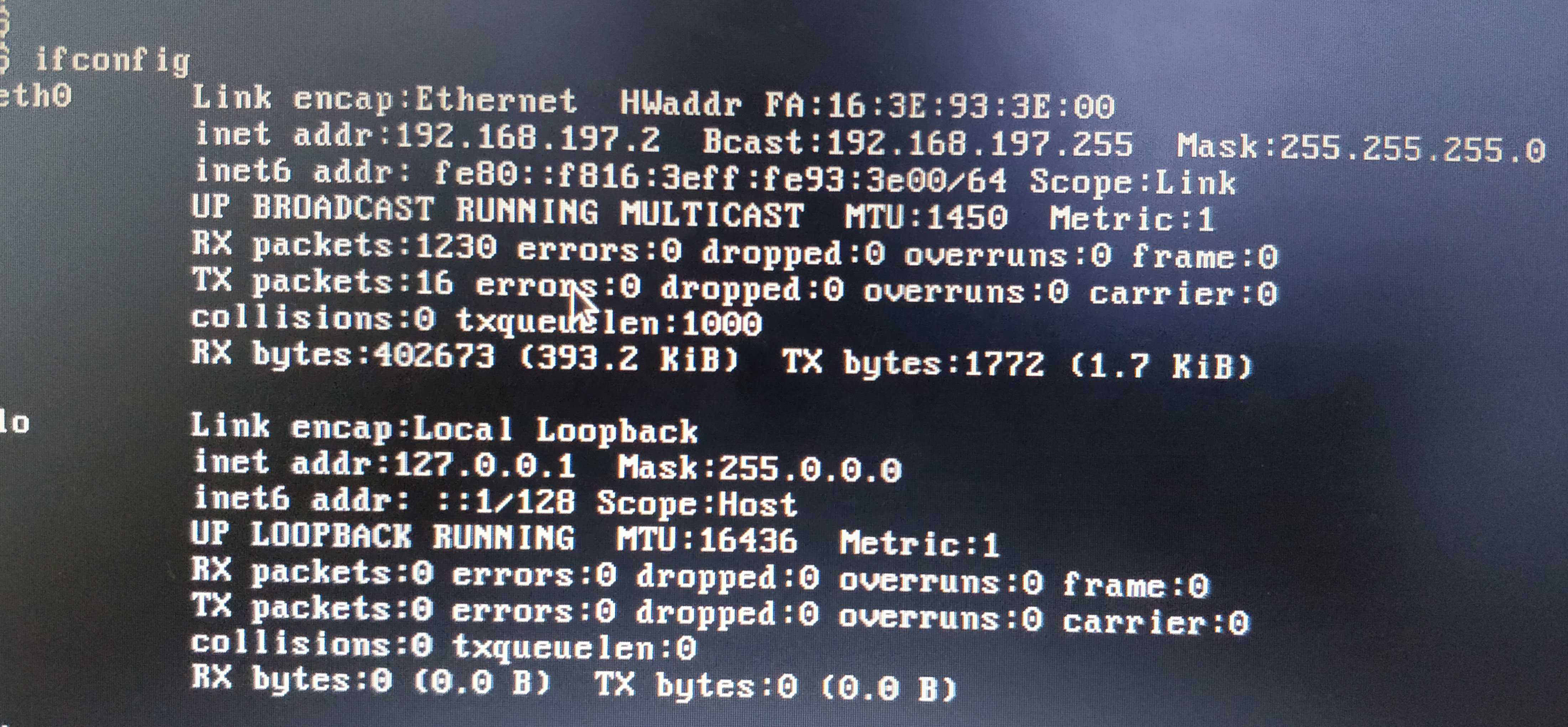

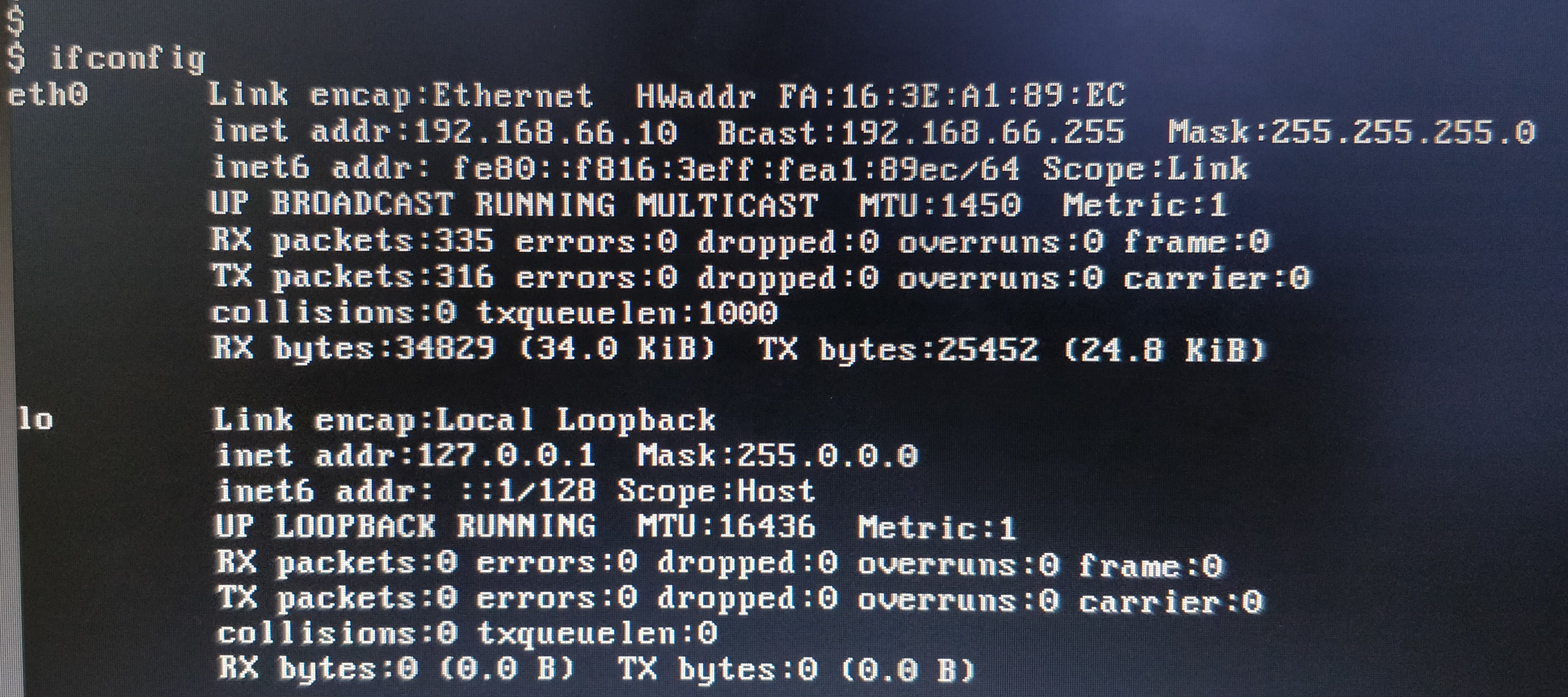

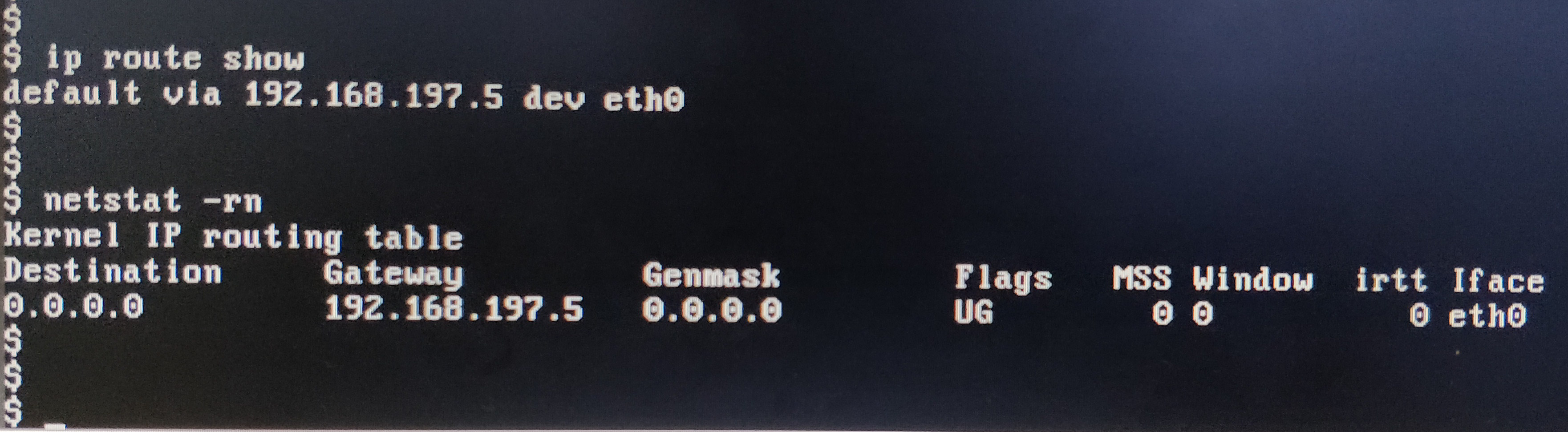

Please posts all the IPs along its masks.
On routerboard:
/ip address print
host1 and host2:
ip addr show (or ifconfig)
ip route show (or netstat -rn)
Thanks for the reply.
I have attached the same for your reference.
Please note that currently the IPs have been changed to :
Host1 IP = Point A = 192.168.197.2
Host2 IP = Point C = 192.168.66.10
Point B = Router ether 1 = 192.168.197.5
Point D = Router ether 2 = 192.168.66.4

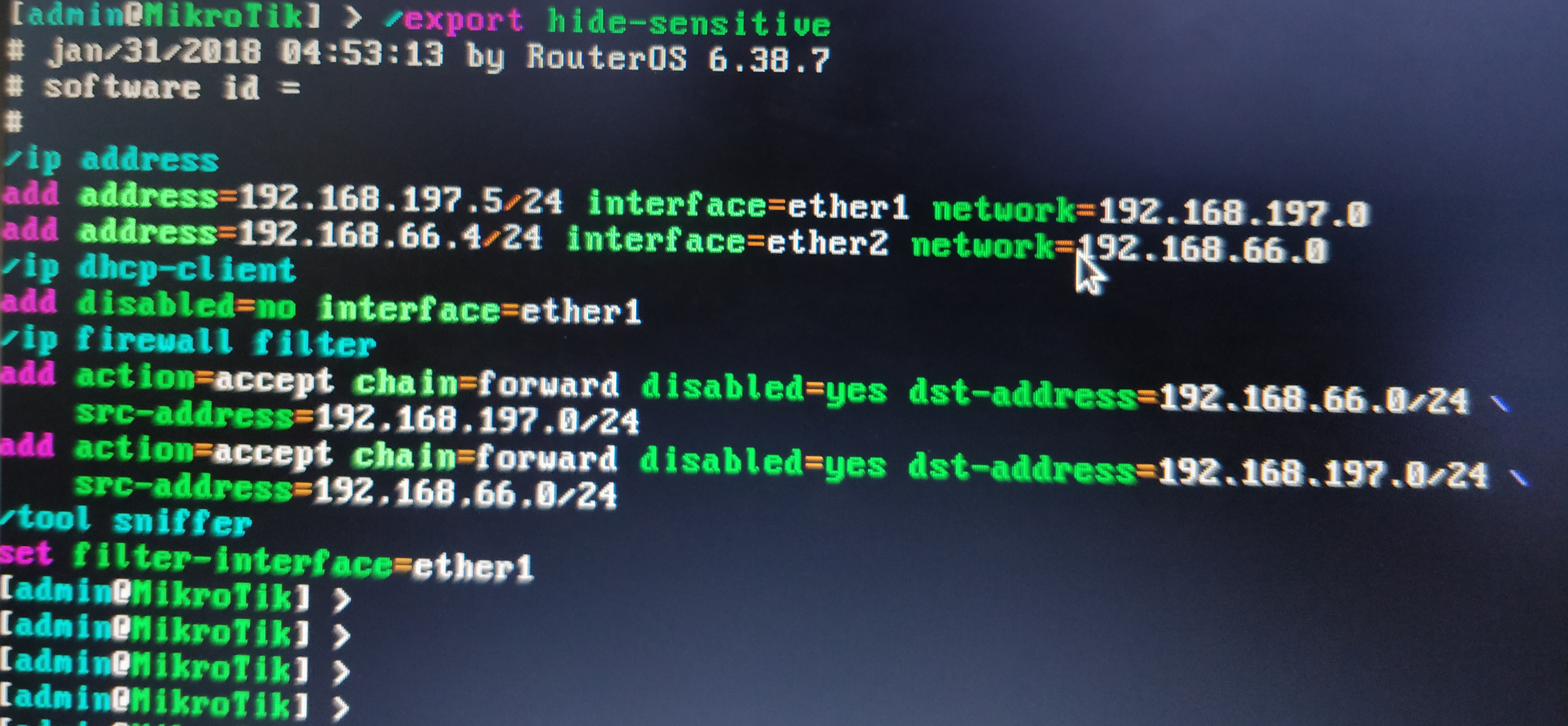

It would be best to post whole config, to rule out something unexpected hiding somehere. Run this on router and post output:
/export hide-sensitive
Text format preferred.
Hi ,
I did this : /ping src-address=192.168.12.6 address=192.168.110.4
i took the tool sniffer on ether 2 , i could observe like 192.168.12.6 has reached ether 2 , no other packets.
I initiated ping from Host 1 to pint D . i took the tool sniffer on ether1 , i could observe both the ips of Host1 and pointD .
Since the ping is not successful , seems like the packet is forwarded to Host1 from point B.
Please help

Hi ,
I understood what am struggling is like ,with the basic thing .
But to be honest am not able to make it up.
I am hiding nothing , because I need to have a solution for this.
I tried with a fresh reload but still not working.
So the config is pretty much empty. You have two interfaces with different subnet on each, inactive dhcp client (judging by previous screenshot of /ip address print), and firewall filter rules explicitly allowing traffic between these subnets (which are unnecessary in this case and you can remove them, because no rules mean everything allowed). Clearly, you can’t do anything here.
It must be something on hosts, try “iptables -L” to see firewall rules there.

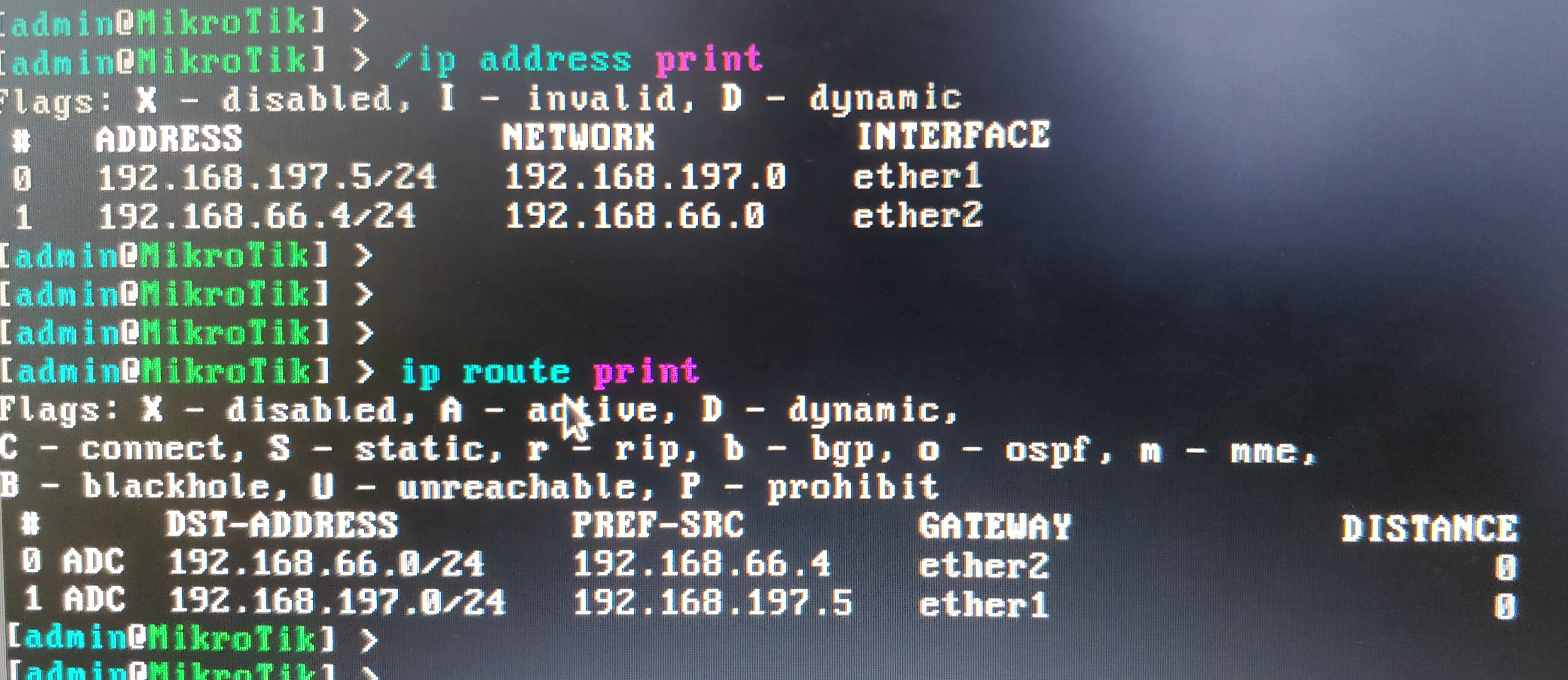

Post
/ip address print
/ip route print
on the mikrotik also. We cannot guess what that dhcp-client on ether1 may end up doing to them.
You shouldn’t have a dhcp-client on an interface with an static ip set…
