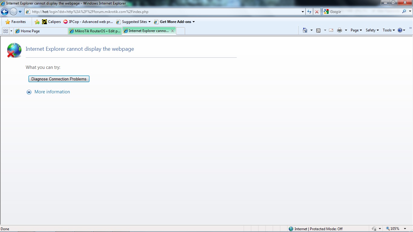

ok i have been messing around with hotspot now that i have had a lilbit more experience with mikrotik.
I have got it all set up and running,
when i click on internet explorere ir redirects me to the hotspot login page. but then it does not load any webpage?
it says checking proxy settings in bottom right and then after some time it says “page cannto be displayed” but the url and all that is right?
what could the problem be?

then when i enable the hotspot again, and refrsh the webpage it directs me to:
http://hot/login?dst=http%3A%2F%2Fforum.mikrotik.com%2Findex.php
but gives me the page cannot be found screen.
cheack attached
ok i found my problem.
I was putting a DNS name in when i dont have like a registered dns, i thought it was just the name you wanted to type in ie and it would take you to the hotspot.
