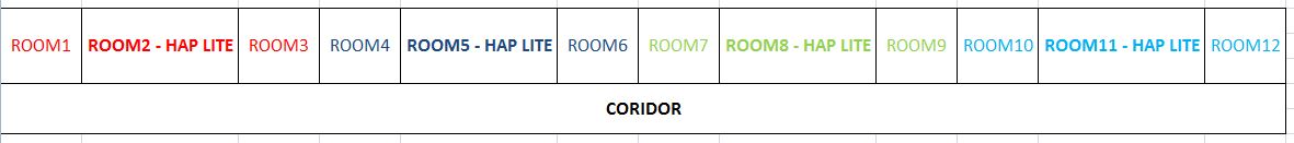

hotel room wifi with hap lite
i am thinking of installing hap lite inside room so it shares internet in same room and next room at right and next room at left. so 1 hap lite for three rooms.
i am thinking of this idea instead of installing wap or rb951ui in the corridor
any opinions.
one problem is theft of hap lite from the room.
second thought. is it enough for serving three rooms mobile devices? and bypsassing 1 concrete wall from main room left-right room?
here is the room plan of a floor.
room2 hap lite covers room1,room2,room3
room5 hap lite covers room4,room5,room6 etc

is just one wall only. imagine you are inside a hotel room and you have one ap. next room should get the signal also.

in the next screen ap will be inside room 3.
I believes yes. Go to the hotel and make a survey.
Why not put the access points in the corridor? That way there is at most 1 door between any room and an AP. The signal should penetrate the door easier than a wall. You could even spoil your guests with something like HAP AC in an enclosure.
if i put in the corridor yes for the one door of the room 3 in the diagram is exact outside. for the other doors are far away to penetrate.

i have make my measures with hap lite (good reception 2.4 mhz) AND hap ac (not very good reception with 5ghz inside the room)
i will use 1 ap per 4 block of rooms and 1 ap per 2 rooms in a row. the ap’s will be installed outside of the doors of the rooms in the corridor.
