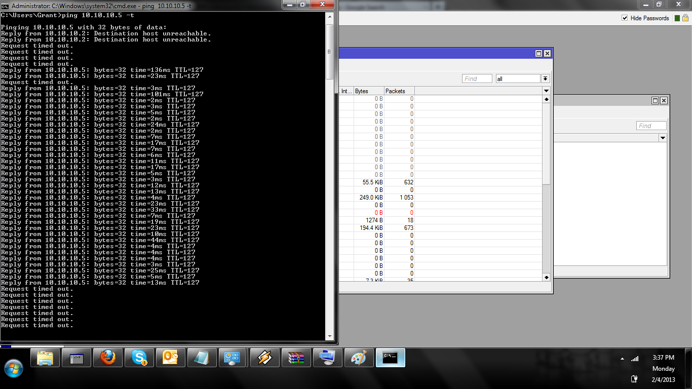

There are 2 screenshots attached. The first (fig.1) is from my pc trying to ping the pc with shared content and the second (fig.2) is what happens after the mikrotik is rebooted. All seems to work after a reboot, but then with eventually stop pinging and revert to fig.1. Note that both pcs are connected directly to the wlan interface on a test router i set up at my office to try and replicate the scenario. This also proves that the problem is not network specific but to do with the hotspot setup itself.
