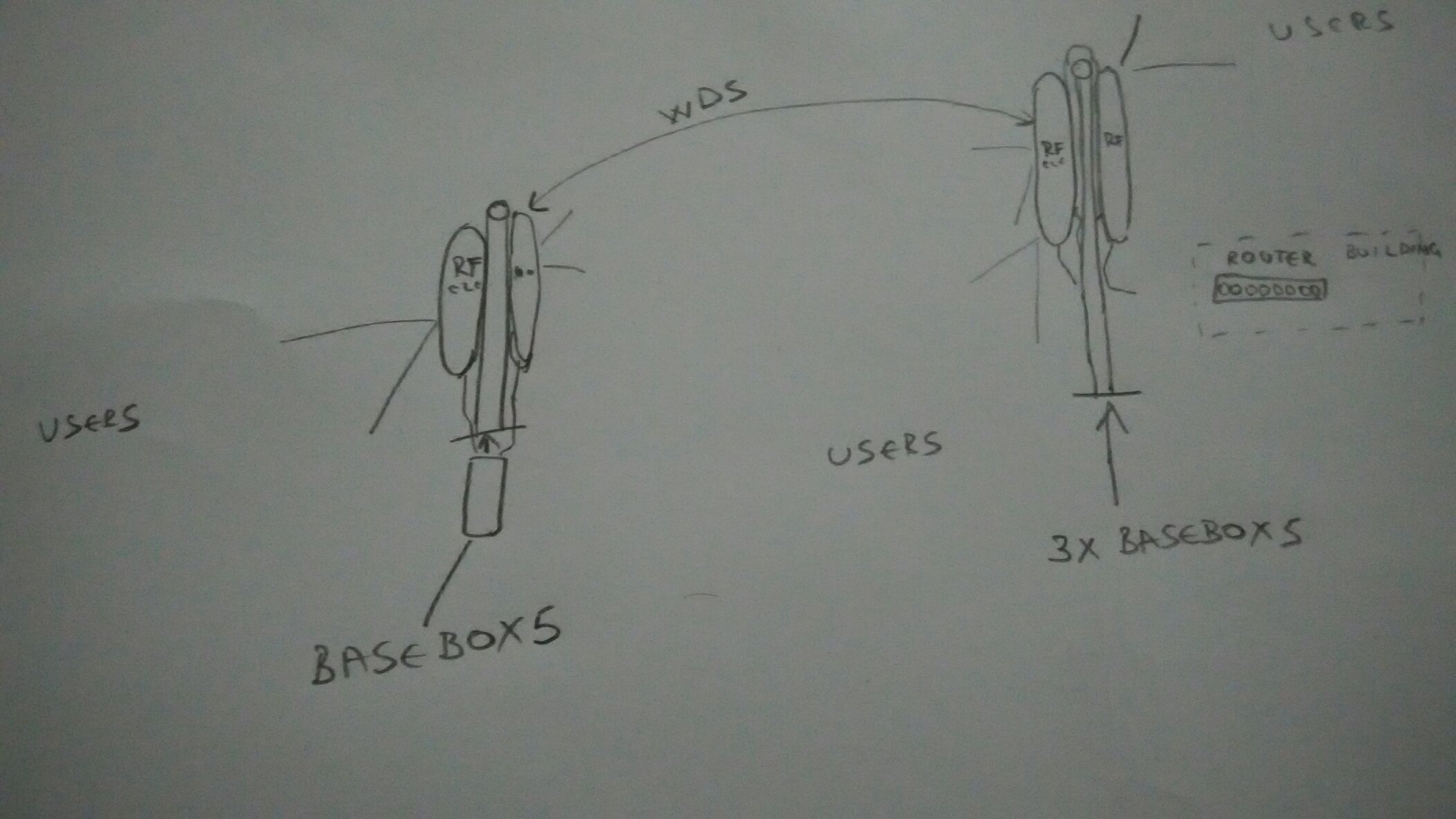

Dear friends,
I have to make a setup for wireless distribution and I have 4 PCS of BaseBox 5 and 5 PCS of RF elements sector antennas. I have two locations and one tower will have 3 x BaseBox 5 while the other one will have 1 with two antennas. The location where I have 2 antennas and one BB5 is remote location and internet will be supplied from the other side (WDS between left BB5 and one of the right BB5 looking to that direction). There will be also one mikrotik router which will initiate the connection to the internet and all 3 BB5 from the right side on the picture will be connected via UTP to it. The system will be configured for up to 300 users. The photo I am uploading is a fast hand drawing cause I don’t have MS Visio here at the moment to draw it better with more details.
I would like to ask:
  1. Can it work in WDS like I described and like it is on the photo?
  2. How should I make the whole network setup?
  3. Where should I set hotspot and DHCP server? In the router which is in the building or somewhere else?
Note: All stations will work on the same frequency and same SSID.
Please advise and suggest… correct…
