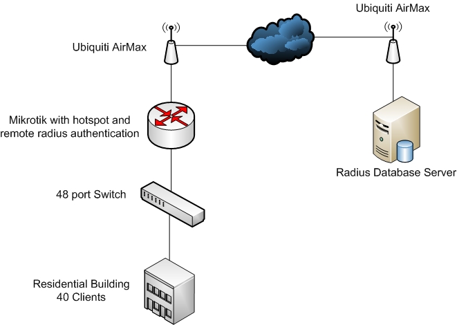

Hello guys, I am attaching a simple diagram to what I would like to be able to do. The question is simple:
Which routerboard model should I use in this setup?

Any with a license level 4. A 750G should be able to handle 40 clients that only log in occasionally just fine, a 450G could definitely do it, anything above can, too.
