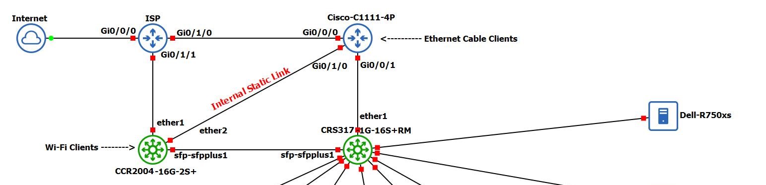

I need help with the Mikrotik hotspot and on-prem Windows AD. In this topology, we have two routers one Cisco and one Mikrotik CCR router. The AD server takes it’s IP address and its connected to the Cisco router and the wireless clients takes it’s IP’s and are connected to the Mikrotik CCR router with hotspot enabled. End to end connectivity is established. WiFi Clients can ping AD and AD can ping WiFi clients also but when I try to join WiFi clients to the domain it fails. Windows firewall has been disabled but it still fails. But when I disable the hotspot server on the Mikrotik CCR I am able to join the WiFi clients to the domain. Also, I tried adding the AD’s IP to the walled garden and walled garden IP list but still, I still cannot add the clients to the domain. But they work perfectly well when I disable the hotspot service on the Mikrotik router.
